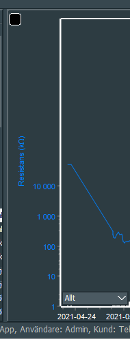

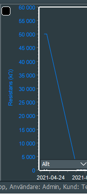

Hello!
I attached two images showing my chart. One with LogarithmicBase set to False and the other one with LogarithmicBase set to true. This is the only modification done in the program between the two screenshots. Min, max values are set to 0 - 60000.
Why is the Log view only occupying half screen? I have used the program for ages without any problems but sometime last year this problem started when compiling new versions..
Best regards, Mikael
Logarithmic view
Linear view
Re: LogarithmicBase not working
Post by Yeray » Wed Jan 11, 2023 8:24 am
Sounds as the issue reported here.
Could you please give it a try at the sources modification to see if it solves the problem for you?
Lenfors
Posts: 5
Joined: Fri Sep 09, 2022 12:00 am
Post by Lenfors » Mon Jan 30, 2023 10:15 am
Thank!
It solved the problem. Will this be fixed in the next release?
Post by Yeray » Mon Jan 30, 2023 10:18 am
Of course!
