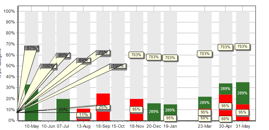

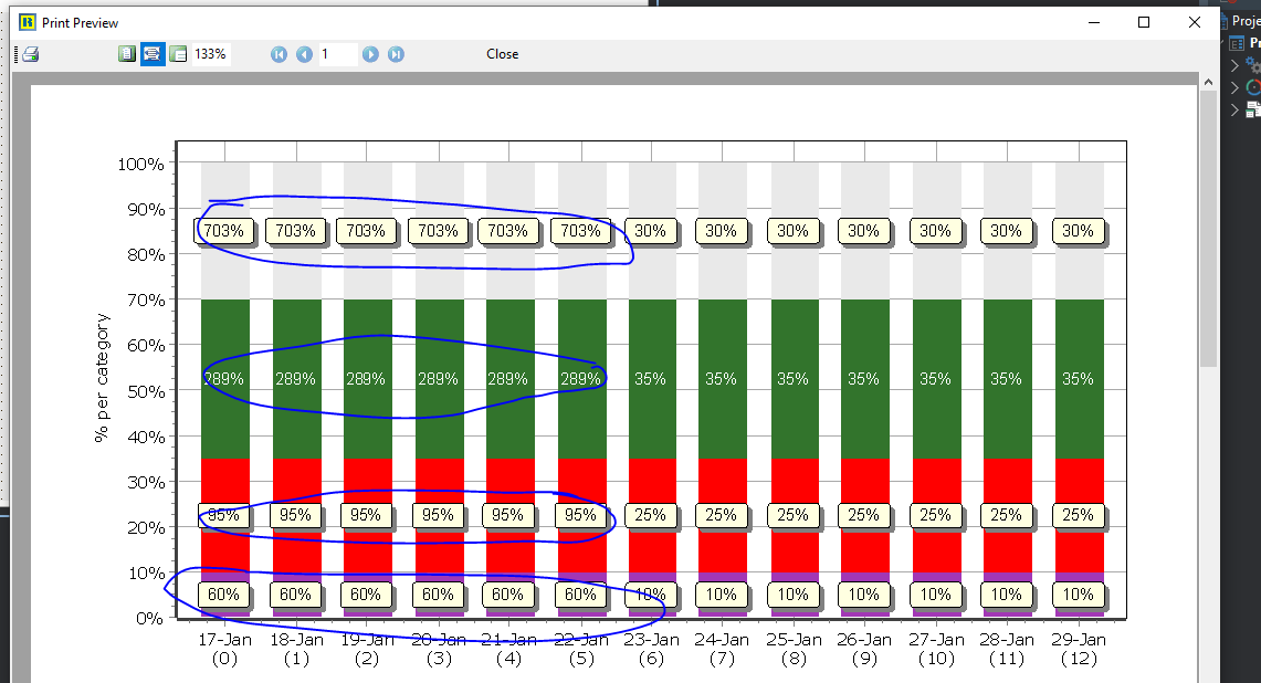

After migrating from D10.2.3 to D11.2.1 and updating Steema (v36.220929)/Reportbuilder(21.05), we experience some strange behaviour in the prints of the TCharts.
All bars have the same values, but when counting from right to left, from the 7th bar, the mask is displaying wrong texts.
Code sample project can be found at http://bugs.steema.com/show_bug.cgi?id=2580
marks sample.PNG (63.77 KiB) Viewed 10373 times
In our production environment (no code available) some masks are even drawn with a static position in their shape?
Marks production.PNG (67.58 KiB) Viewed 10373 times

In the .dfm of your project I can see the TBarSeries have Marks.Items defined.
Remove them and it should be fine.

Post by UNIFORM-Agri » Thu Feb 02, 2023 8:04 pm
Ouch.. that one was my bad :-)
After removing the static marks, the values are good.
Altough the marks (yellow frame) are still drawn with a strange bottom-left position. Altough not in my demo-project, but still is on the production environment. Work-around for me is to make the marks transparent so arent drawn anymore.
I haven't been able to reproduce that one.
If you find how to reproduce it in a simple example project we can run as-is, don't hesitate to share it with us.
