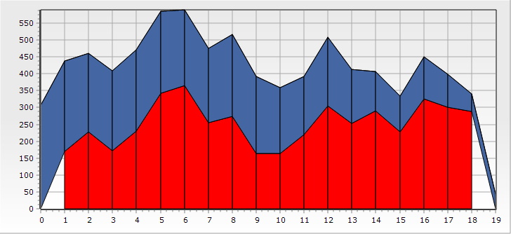

I've spent hours working on this and getting it working, only to find another where it doesn't work.
In the attached demo, a chart is created with area series that should step down to zero when the next value is zero or from zero when the previous value was zero. I can get it working some of the time, but I can't get it working for all four options.
In the demo, there are two methods for creating the char: UpdateChart1 and UpdateChart2, Clicking on the "Illustration #..." radio button produces different results. The combo box on the top right selects which chart method is used. UpdateChart1 shows the chart correctly but doesn't do the stepping. UpdateChart2 has different problems, depending upon which illustration is selected. (The chart is supposed to have a smooth upper line, showing income in retirement).
How can I achieve this?

Could you please draw what's the result you'd like to obtain? I'm not sure to understand it.
Test Always #? wrote:
Mon Mar 20, 2023 8:34 pm
I see in UpdateChart2 you are adding zeros to draw stairs/steps (instead of slopes) when going from/to a zero. But I'm not sure to see what's wrong with that approach.

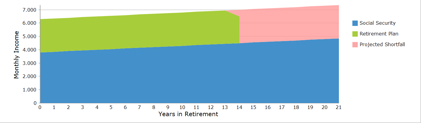

Post by Test Always #? » Thu Mar 23, 2023 5:09 pm
Thank you for your response.
Here is a link to an image that I have working (sorry, I could not get the "img" tags to work and display the image in the preview):
http://www.tbinc.com/misc/A.jpg
When the cash flows get more complex, it falls apart--e.g., incomes starting and stopping. It took me a lot of work to get this one working.
I need them to step down, not slide down.
Does that make sense?

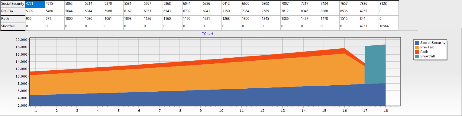

Checking this to see how it can be done. If the rules are:
1. If a value is followed by a zero then no direct join is made to the next point, rather a step downwards is made at the x-location of the last non-zero value.
2. If the predecessor to a value is zero, no direct join is made rather a step up is made at the x-location where the non-zero value occurs.
That would give this chart (a simulation) for the data in the example project:
Does that agree with what you expect to see?

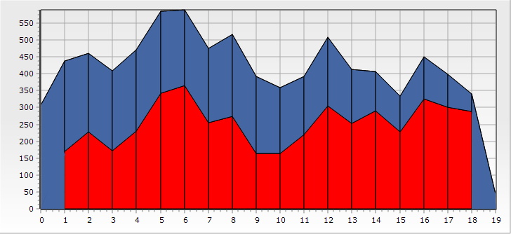

We see a obstacle to us adding the step-up/down as a generic feature because for stacked charts, if another series in the stack has values and another doesn't, a stack could show up as hollow
ie.
which is, data-wise, true to the values of the blue series, but aesthetically not particularly attractive,
or .... to fill-down the blue.
ie.
which is aesthetically easier on the eye, but data-wise gives the impression that, for example, the penultimate blue value is very large, which it isn't.
We are up for thinking this through further and working with any feedback, but at the moment we feel that a generic implementation wouldn't be true to the data in many cases.

I made a simple example trying to replicate the image you posted above.
Here the result:
And the code to make it:
