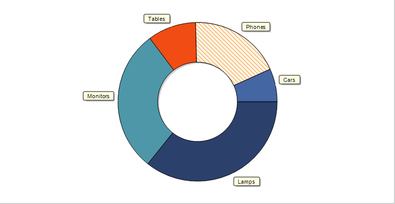

I want to set pattern for specific slice in Donut chart. Is its possible ?
I found UsePatterns property but if set they draw all slices with pattern. But I need specific ones.
So, how to select pattern type, foreground and background colors for specific slise ? Maybe using some event ?
Result should looks like this (made by hand):
Thanks for help !

You can do something similar to the explained here:
type TDonutSeriesAccess=class(TDonutSeries);
  Chart1.AddSeries(TDonutSeries).FillSampleValues(5);
  Chart1.OnAfterDraw:=PatternInDonutSliceAfterDraw;
procedure TForm1.PatternInDonutSliceAfterDraw(Sender: TObject);
var donut: TDonutSeriesAccess;
  if (Chart1.SeriesCount>0) and (Chart1[0] is TDonutSeries) then
    donut:=TDonutSeriesAccess(Chart1[0]);
    if pie.Count>1 then
      Chart1.Canvas.Brush.Color:=donut.GetValueColor(1);
      Chart1.Canvas.Brush.Style:=bsFDiagonal;
      donut.DrawPie(1);

Thank you very mush ! I will try !

Post by amsus2021 » Fri Jun 02, 2023 4:30 pm
Its working perfect ! Thank you very much !
