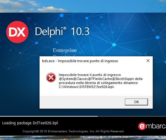

I'm trying to install TeeChartVCLFMXStandard-2023.37 with Delphi 10.3 (O.S. Windows 10 Pro 22H2 19045.2965)

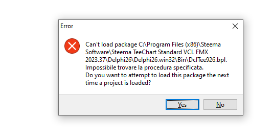

The installation itself works but at Delphi boot I receive a series of exceptions concerning the impossibility of finding the entry points of the various bpl

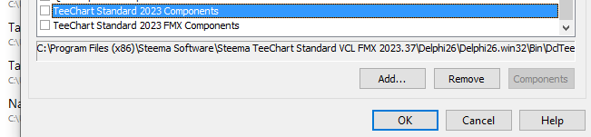

From the package list in Delphi, none have been installed (not checked) and if I try to check the packages I get the same exceptions

- Sample error at boot delphi
- cantload.png (12.01 KiB) Viewed 58644 times
- install packages list
- error install package.png (11.03 KiB) Viewed 58644 times
- error n 1.png (208.56 KiB) Viewed 58644 times

Do you have all the updates installed in the IDE?
https://docwiki.embarcadero.com/RADStud ... at%27s_New
Note we always build the binary installers with all the updates installed, and these kind of errors use to mean some packages in the IDE are different to those used to build the packages.

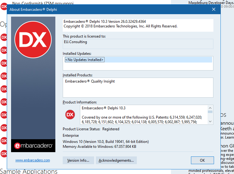

I have 10.3 release 1 patched ide 1
unfortunately I can no longer install 10.3.3 as my update license has expired and from this year the embarcadero won't let you download even if you have the perpetual license
it is unfair of them but there is no way except by buying the 11

- delphi version
- delphi ver.png (61.6 KiB) Viewed 58628 times

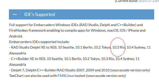

I don't find it professional of Steema to sell a product without exact specifications.Yeray wrote: ↑Tue May 23, 2023 12:55 pmHello,

In the notes we talk about the supported version of delphi 10.3, we don't talk about subversion.

With patience and considerable waste of time (and my time is worth as much as yours) I tracked down the version that works with my Delphi 10.3 the fact remains that a few days ago I bought a new product and I just have to use one from 2019 because the versioning problem is not clearly explained.

- from your site
- Immagine.png (19.33 KiB) Viewed 58574 times

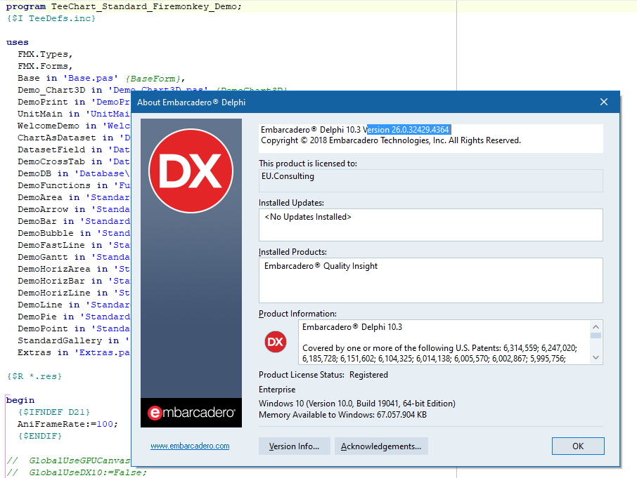

The version I use is delphi 10.3 Version 26.0.32429.4364
I am also attaching the screen shoot of the delphi version to be more sure (delphiver.png)

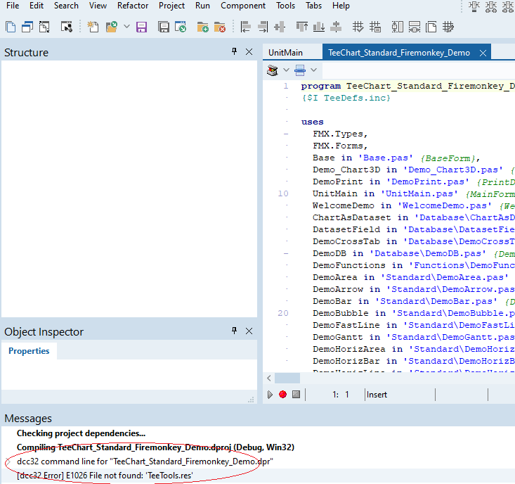

I inform you that the demo Teechart_Standard_Firemonkey_Demo has a compilation error, the TeeTools.res is missing (I am attaching a screen shoot)

- compiler error demo teechart
- compiler error example teechart.png (46.09 KiB) Viewed 58504 times
- delphi ver 10.3
- Delphi ver.png (75.15 KiB) Viewed 58504 times
