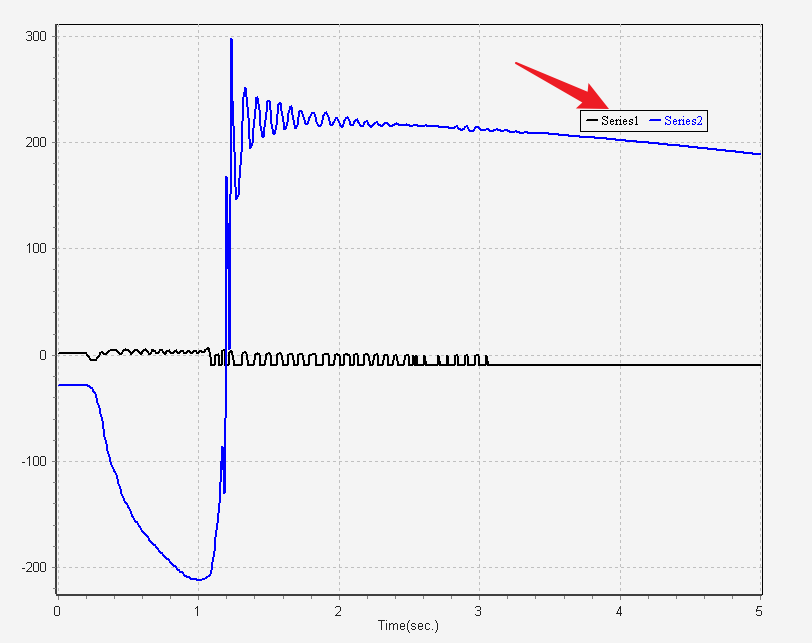

Why is it possible to drag by default?
How to prevent the legend from being dragged?

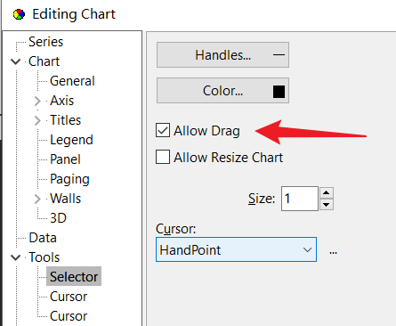

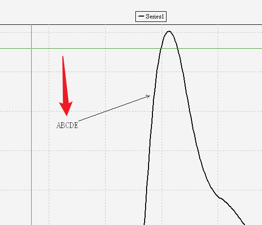

I found the reason。
I added a selection tool to achieve drag and drop annotation functionality。
This causes the legend to also be dragged. How to solve this problem???

Indeed, the TAnnotationTool doesn't support dragging. However, the TRectangleTool does.
So, instead of having a TAnnotationTool and adding a TSelectorTool to add dragging support to it, you could just use a TRectangleTool.

How to prevent the legend from being dragged during the chartmousemove event, as shown in the following example???
