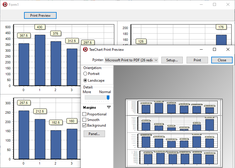

to print several charts on one page I have a form containing a TeePreviewPanel.
In my MainForm I have the following code to show the print preview:
procedure TMainForm.ShowPrintPreview(Sender: TObject);
  Chart1.PrintProportional:=False;
  Chart2.PrintProportional:=False;
  Chart3.PrintProportional:=False;
  Chart4.PrintProportional:=False;
  Chart1.PrintMargins:=Rect(2,2,2,76);
  Chart2.PrintMargins:=Rect(2,25,2,51);
  Chart3.PrintMargins:=Rect(2,50,2,26);
  Chart4.PrintMargins:=Rect(2,75,2,2);
  with frmPrintPreview.TeePreviewPanel1 do begin
    Panels.Clear;
    Panels.Add(Chart1);
    Panels.Add(Chart2);
    Panels.Add(Chart3);
    Panels.Add(Chart4);
   frmPrintPreview.ShowModal;
When the preview form is shown only one chart is visible. Only when i move the window or change its size the charts will be displayed correctly. I have tried to call Repaint and Refresh with no success. How can I solve the problem?
A second question: How can I insert a text on top of the panel? I want to insert a title before printing and tried the following:
  with TeePreviewPanel1.DelphiCanvas do begin
    Font.Height := 10;
    Font.Color := clBlack;
    TextOut(50,10,'My Title here');
but the text is not visible. What is the correct code to do this?
Thank you in advance
Metek

The following simple example seems to work fine for me here:
uses Chart, Series, TeePrevi, TeePreviewPanel;
var Charts: array of TChart;
procedure TForm1.BPrintPreviewClick(Sender: TObject);
var preview: TChartPreview;
  Charts[0].PrintProportional:=False;
  Charts[1].PrintProportional:=False;
  Charts[2].PrintProportional:=False;
  Charts[3].PrintProportional:=False;
  Charts[0].PrintMargins:=Rect(2,2,2,76);
  Charts[1].PrintMargins:=Rect(2,25,2,51);
  Charts[2].PrintMargins:=Rect(2,50,2,26);
  Charts[3].PrintMargins:=Rect(2,75,2,2);
  preview:=TChartPreview.Create(Self);
  with preview.TeePreviewPanel1 do begin
    Panels.Clear;
    Panels.Add(Charts[0]);
    Panels.Add(Charts[1]);
    Panels.Add(Charts[2]);
    Panels.Add(Charts[3]);
  preview.ShowModal;
  function CreateChart: TChart;
    Result:=TChart.Create(Self);
    with Result do
      Parent:=Self;
      Color:=clWhite;
      Gradient.Visible:=False;
      Walls.Back.Color:=clWhite;
      Legend.Hide;
      View3D:=False;
    Result.AddSeries(TBarSeries).FillSampleValues;
var i: Integer;
  SetLength(Charts, 4);
  for i:=0 to 3 do
    Charts[i]:=CreateChart;
    with Charts[i] do
      Left:=i mod 2 * Width;
      Top:=(i div 2 * Height) + Panel1.Height;
  Width:=(Charts[0].Width*2) + 15;
  Height:=(Charts[0].Height*2) + Panel1.Height + 38;
Could you please modify it so we can reproduce the problem here?

Post by Metek » Wed Aug 09, 2023 4:11 pm
Hello Yeray,
i was close to desperation to locate the problem in my application, but now I can reproduce it.
In my application each of the 4 charts is assigned to separate page of a PageControl.
If I start the application and immediately call up the print preview before all pages have been displayed once, the print preview does not work. This only happens the first time I call it up.
To demonstrate the effect, I have modified your example programm a little:

Post by Metek » Mon Aug 14, 2023 6:53 am
Does anyone have a solution or workaround for the prolem?

Post by Marc » Mon Aug 14, 2023 11:43 am
Hello Metek,
I'm checking what repaint method can force the render but haven't found one yet other than CopyToClipboard, which works but, as the name implies, leaves a chart on the clipboard.
ie.
Charts.CopyToClipboardBitmap;

Post by Metek » Thu Aug 17, 2023 6:02 am
Hello Marc,
thanks for the workaround, it works well.
The clipboard can then simply be deleted with Clipboard.Clear
Kind regards

Post by Yeray » Wed Aug 23, 2023 2:12 pm
As an alternative to that workaround, forcing the charts to be drawn works fine for me:
    i: Integer;
    Panels.Clear;
    for i:=0 to High(Charts) do begin
      Charts[i].Draw;
      Charts[i].PrintProportional:=False;
      Panels.Add(Charts[i]);
  preview.ShowModal;
  preview.Free;
