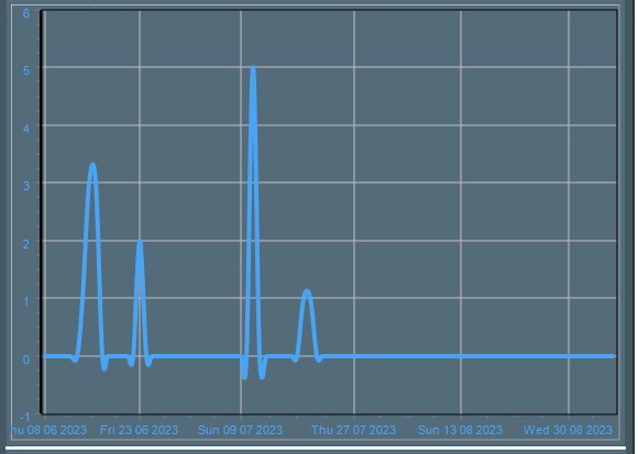

Post by Cortech » Wed Sep 06, 2023 6:24 am
I am facing an issue with the Line chart series of TChart when using the DrawStyle Curve. The line is going below 0, even though none of the values are below zero (please refer to the attached image). I am looking for a solution to prevent the line from dipping below zero and maintain the curve style. Any help would be greatly appreciated, and thank you in advance for your responses.

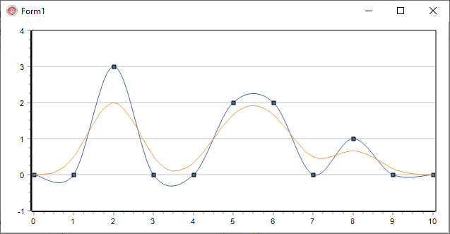

Re: TChart Line Chart Series with DrawStyle Curve Dips Below Zero - How to Fix?
Post by Yeray » Wed Sep 06, 2023 9:41 am
I'd say this is something to expect if you want the curve to pass through the points.
If you don't need the curve to pass though the points, you can use a TSmoothingFunction with Interpolate:=false as follows:
uses Chart, Series, TeeSpline;
var Chart1: TChart;
  Chart1:=TChart.Create(Self);
  with Chart1 do
    Parent:=Self;
    Align:=alClient;
    Color:=clWhite;
    Gradient.Visible:=False;
    Walls.Back.Color:=clWhite;
    Legend.Hide;
    View3D:=False;
    Axes.Left.SetMinMax(-1, 4);
    Axes.Left.Increment:=1;
    Axes.Bottom.Grid.Hide;
  with TLineSeries(Chart1.AddSeries(TLineSeries)) do
    Pointer.Show;
    Pointer.Size:=2;
    DrawStyle:=dsCurve;
    Add(0);
    Add(0);
    Add(3);
    Add(0);
    Add(0);
    Add(2);
    Add(2);
    Add(0);
    Add(1);
    Add(0);
    Add(0);
    FunctionType:=TSmoothingFunction.Create(Self);
    with TSmoothingFunction(FunctionType) do
      Interpolate:=False;
      Factor:=6;
    DataSource:=Chart1[0];

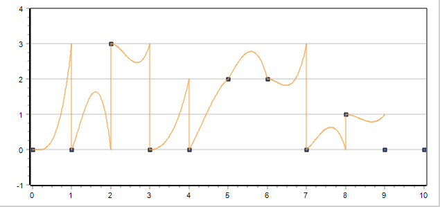

Cortech
Joined: Wed Oct 05, 2022 12:00 am
Post by Cortech » Tue Sep 12, 2023 9:06 am
Thank you so much for the response.
Please note, that I am expecting the curve to pass through the points because it will affect the presented information.
Thank you
V
Posts: 9671
Post by Yeray » Tue Sep 12, 2023 10:22 am
I've tried with a custom cubic spline, but it doesn't give the result I'd expect:
uses Chart, Series;
var Chart1: TChart;
type TCoeficient = record
    X, Y, b, c, d: Double;
type TCoeficients = array of TCoeficient;
type TPoints = array of TPointFloat;
procedure CalculateCubicSplineCoefficients(const Points: TPoints; var Coefficients: TCoeficients);
var
  N, i: Integer;
  h: array of Double;
  alpha, l, mu, z: array of Double;
  c, b, d: array of Double;
  N := Length(Points) - 1;
  SetLength(h, N);
  SetLength(alpha, N);
  SetLength(l, N);
  SetLength(mu, N);
  SetLength(z, N);
  SetLength(c, N);
  SetLength(b, N);
  SetLength(d, N);
  // Calculate h values
  for i := 0 to N - 1 do
    h[i] := Points[i + 1].X - Points[i].X;
  // Calculate alpha, l, mu, and z values
  for i := 1 to N - 1 do
    alpha[i] := (3.0 / h[i]) * (Points[i + 1].Y - Points[i].Y) - (3.0 / h[i - 1]) * (Points[i].Y - Points[i - 1].Y);
    l[i] := 2.0 * (Points[i + 1].X - Points[i - 1].X) - h[i - 1] * mu[i - 1];
    mu[i] := h[i] / l[i];
    z[i] := (alpha[i] - h[i - 1] * z[i - 1]) / l[i];
  // Calculate c, b, and d values
  for i := N - 1 downto 0 do
    c[i] := z[i] - mu[i] * c[i + 1];
    b[i] := (Points[i + 1].Y - Points[i].Y) / h[i] - h[i] * (c[i + 1] + 2.0 * c[i]) / 3.0;
    d[i] := (c[i + 1] - c[i]) / (3.0 * h[i]);
  // Store the coefficients
  SetLength(Coefficients, N);
    Coefficients[i].X := Points[i].X;
    Coefficients[i].Y := Points[i].Y;
    Coefficients[i].c := c[i];
    Coefficients[i].b := b[i];
    Coefficients[i].d := d[i];
procedure GenerateSmoothCurve(const Coefficients: TCoeficients; var SmoothCurve: TPoints);
var
  i, j: Integer;
  t: Double;
  // Calculate the smooth points along the curve
  SetLength(SmoothCurve, 0);
  for i := 0 to High(Coefficients) - 1 do
    for j := 0 to 100 do // 100 points between each pair of input points
      t := j / 100;
      SetLength(SmoothCurve, Length(SmoothCurve) + 1);
      SmoothCurve[High(SmoothCurve)].X := Coefficients[i].X + t * (Coefficients[i + 1].X - Coefficients[i].X);
      SmoothCurve[High(SmoothCurve)].Y :=
        Coefficients[i].Y + t * (Coefficients[i + 1].Y + t * (Coefficients[i + 1].b + t * Coefficients[i + 1].c)) + t * t *
        (Coefficients[i + 1].d);
var i: Integer;
    data: TPoints;
    coeficients: TCoeficients;
  with Chart1 do
    Parent:=Self;
    Align:=alClient;
    Color:=clWhite;
    Legend.Hide;
    View3D:=False;
  with TPointSeries(Chart1.AddSeries(TPointSeries)) do
    Pointer.Size:=2;
    Add(0);
    Add(0);
    Add(3);
    Add(0);
    Add(0);
    Add(2);
    Add(2);
    Add(0);
    Add(1);
    Add(0);
    Add(0);
  // Calculate cubic spline
  SetLength(data, Chart1[0].Count);
  for i:=0 to Chart1[0].Count-1 do
    data[i].X:=Chart1[0].XValue[i];
    data[i].Y:=Chart1[0].YValue[i];
  CalculateCubicSplineCoefficients(data, coeficients);
  GenerateSmoothCurve(coeficients, data);
    for i:=0 to High(data) do
      AddXY(data[i].x, data[i].y);
You could try to modify that algorithm or implement your own.
