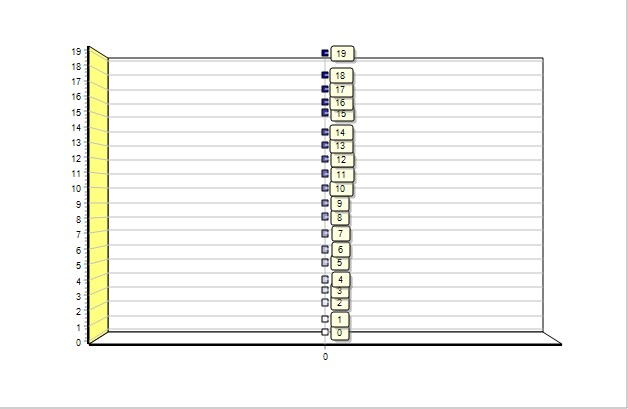

I am visualyzing subsurface borehole data (X,Y,Z) using a TPoint3DSeries. That works fine. However, when I want to display marks with the series that show some text I can only post them above the points. There doesn't seem to be a default option to draw them left or right of a point like there is in Excel (2D) charts.
As most of the boreholes are near vertical this means that the majority of the labels are overlapping and are plotted on top of previous points or labels. Is there a way to solve this?

I'm not sure how are you exactly drawing your TPoint3DSeries but here it is an example showing a simple one with all the points with the same XValue.
Here what I'm getting:
uses TeEngine, Chart,  TeePoin3;
var Chart1: TChart;
var i: Integer;
  Chart1:=TChart.Create(Self);
  with Chart1 do
    Parent:=Self;
    Align:=alClient;
    Color:=clWhite;
    Gradient.Visible:=False;
    Walls.Back.Color:=clWhite;
    Legend.Hide;
    //View3D:=False;
    Chart3DPercent:=100;
    View3DOptions.Orthogonal:=False;
    View3DOptions.Zoom:=80;
    View3DOptions.Rotation:=360;
    View3DOptions.Elevation:=360;
  with TPoint3DSeries(Chart1.AddSeries(TPoint3DSeries)) do
    Marks.Show;
    Marks.Automatic.Move:=False;
    Marks.ArrowLength:=10;
    LinePen.Hide;
    for i:=0 to 19 do
      AddXYZ(0, i, random*3);
    Chart1.Draw;
    OnGetMarkText:=SeriesGetMarkText;
Procedure TForm1.SeriesGetMarkText(Sender:TChartSeries; ValueIndex:Integer; var MarkText:String);
var
  APosition: TSeriesMarkPosition;
  XPos,YPos: Integer;
const XOff=0;
const YOff=0;
  inherited;
  with Sender do
    APosition:=Marks.Positions[ValueIndex];
    if APosition=nil then
      APosition:=TSeriesMarkPosition.Create;
      APosition.Custom:=True;
    XPos:=CalcXPos(ValueIndex);
    YPos:=CalcYPos(ValueIndex);
    APosition.LeftTop.X:=XPos+Marks.ArrowLength+Round(XOff);
    APosition.LeftTop.Y:=YPos-(APosition.Height div 2)+Round(YOff);
    APosition.ArrowFrom:=Point(XPos,YPos);
    APosition.ArrowTo:=Point(APosition.LeftTop.X+(APosition.Width div 2),APosition.LeftTop.Y+(APosition.Height div 2));
    Marks.Positions[ValueIndex]:=APosition;
