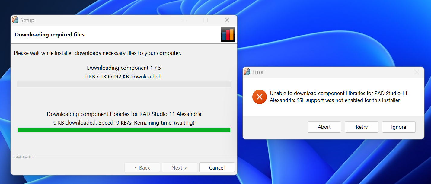

I am trying to install TeeChart Pro VCL, on my Win11 PC, with Embarcadero RAD Studio 11 Alexandria.
I am getting the flowing message:
What is wrong? How to solve this issue?

Post by Piotr_t4 » Fri Oct 20, 2023 2:49 pm
Fixed after applying recent patch on Alexandria. Or after mounting Embarcadero iso file.

Post by Yeray » Fri Oct 20, 2023 3:02 pm
Sorry, there was a problem in the site causing this problem.
It should work fine now as always.

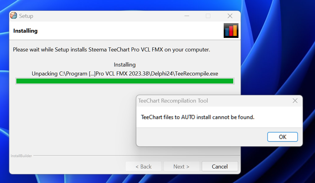

Post by Piotr_t4 » Fri Oct 20, 2023 6:11 pm
Well.... I was a bit too optimistic...
Now I see the following message from "recompilation tool":
TeeChart files to AUTO install cannot be found.
Can anyone give me some tips on how to continue?

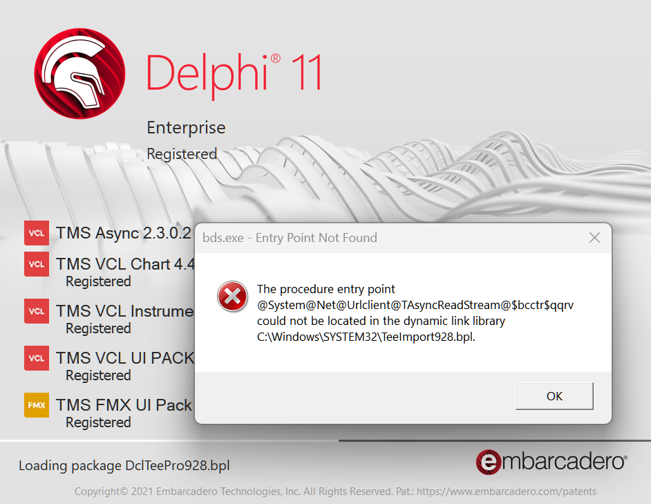

When starting RAD studio (or actually Delphi 11) I see the following message (see the attached picture).
Any clue?

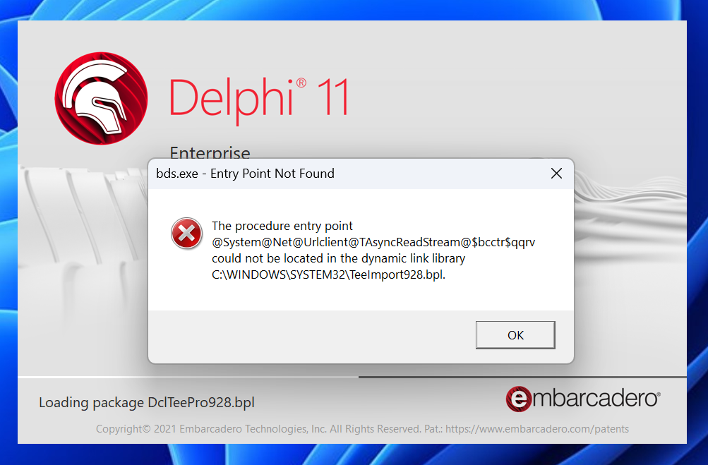

Post by Piotr_t4 » Sat Oct 21, 2023 11:52 am
1). I have uninstalled TMS, uninstalled RAD, uninstalled TeeChart.
2). Installed RAD from iso (radstudio_11_106491a.iso)
3). Installed TeeChart using (TeeChartVCLFMX-2023.38.exe)
This time the AUTO installer of TeeChart did not complain
But starting for the first time Delphi 11, I see the same message (The procedure entry point....). See attached screenshot.
Any clue?

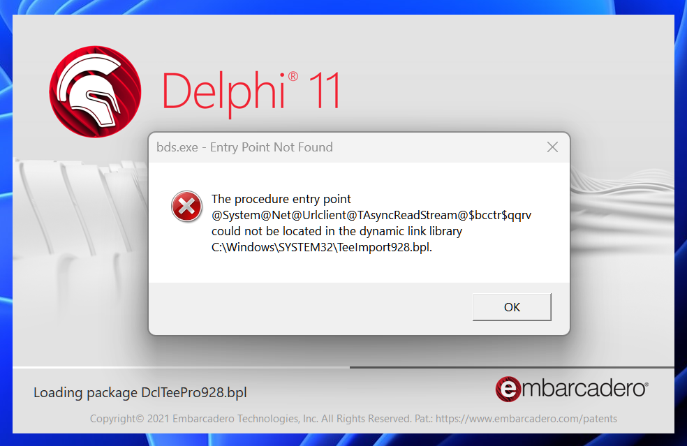

Post by Piotr_t4 » Sat Oct 21, 2023 12:51 pm
To exclude issues with my PC, I have tried to install RAD 11 and TeeChart Pro on clean VMware instance of Win11.
Same result...

Post by Yeray » Sun Oct 22, 2023 11:07 am
This issue is explained here.
I see you've solved it installing the TeeChart v2022.34 as explained there.
Note the other alternatives are to use the latest IDE build with the latest TeeChart binary build, or to use the IDE build you are using and rebuild TeeChart with the source code version.
