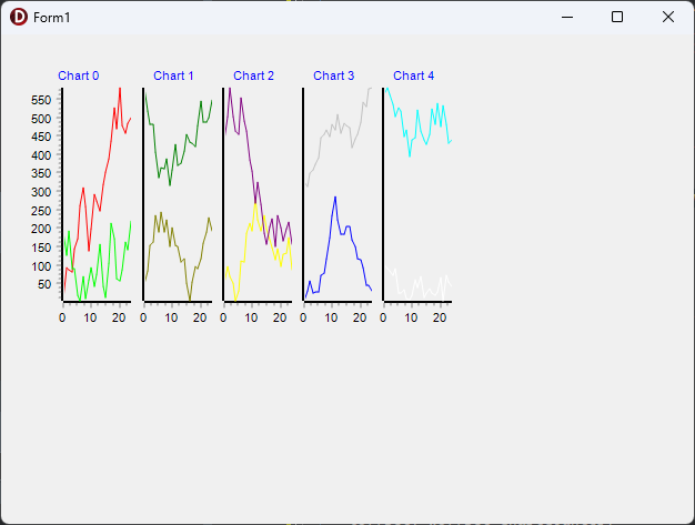

This is what I get, where I measure 61 pixels in all the bottom axes.
Note this is without adding Axes.Left.Axis.Width to the wOffset and commenting the ResizeChart line:

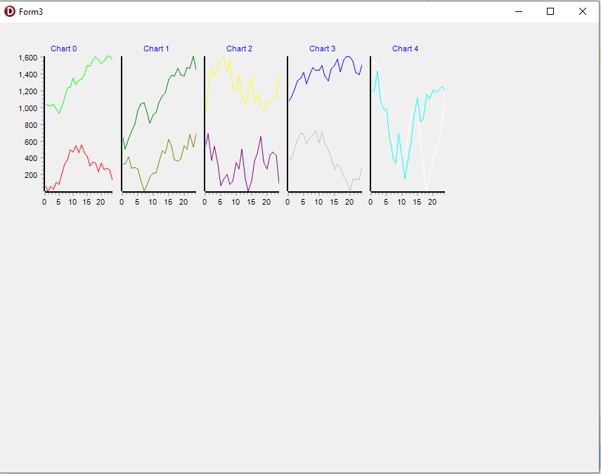

Strange. I get:
The code is the original code, plus your suggested changes.
(Rad Studio 11.2 and the latest version of Teechart Build 2023.39.231109)
