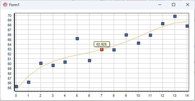

I'm not sure if this solves the problem you are describing but I've done a simple example with my proposal.
In the example I'm populating a TPointSeries with 14 values, from 0 to 14 with a hole at XValue=7.
Then, I'm adding a TFasTLineseries with a TCurveFittingFunction.
Finally, I'm calculating the Interpolation point with the method from here and I'm adding the given value in another TPointSeries.
Here the code:

      AddXY(7, InterpolateLineSeries(Series[1], 7));

Here the result:
