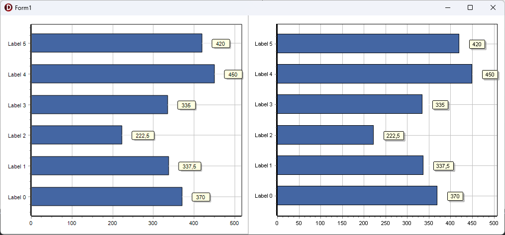

I've copied your code to a simple example with just a THorizBarSeries, and this is how it looks for me:
ScalingGraphic.zip
(2.29 KiB) Downloaded 4693 times
At 100%:
At 175%, the forums seem to rescale the image - open it in a new tab to see the real size:

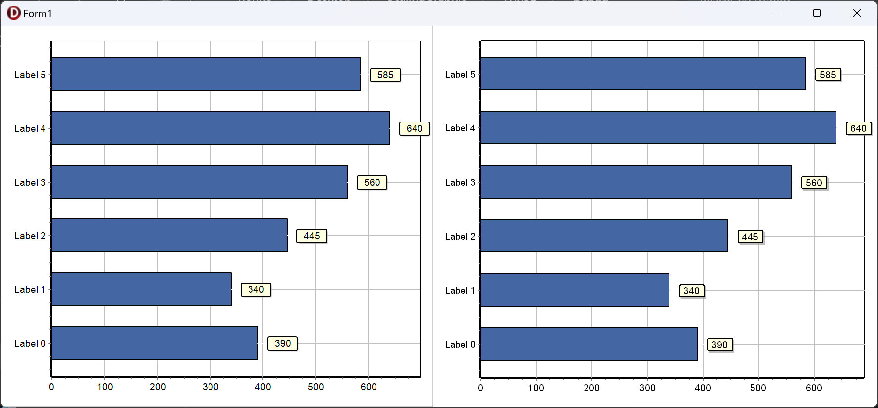

Thank you for the quick response. Here is what I get with your demo:
Chart with 100% scaling.
URL: http://www.tbinc.com/misc/ChartScale100.jpg
And at 200%:
URL: http://www.tbinc.com/misc/ChartScale200.jpg
(Any idea why my image tags do not work?)
How do I prevent scaling the created image? It ends up looking bad in the printed report.
