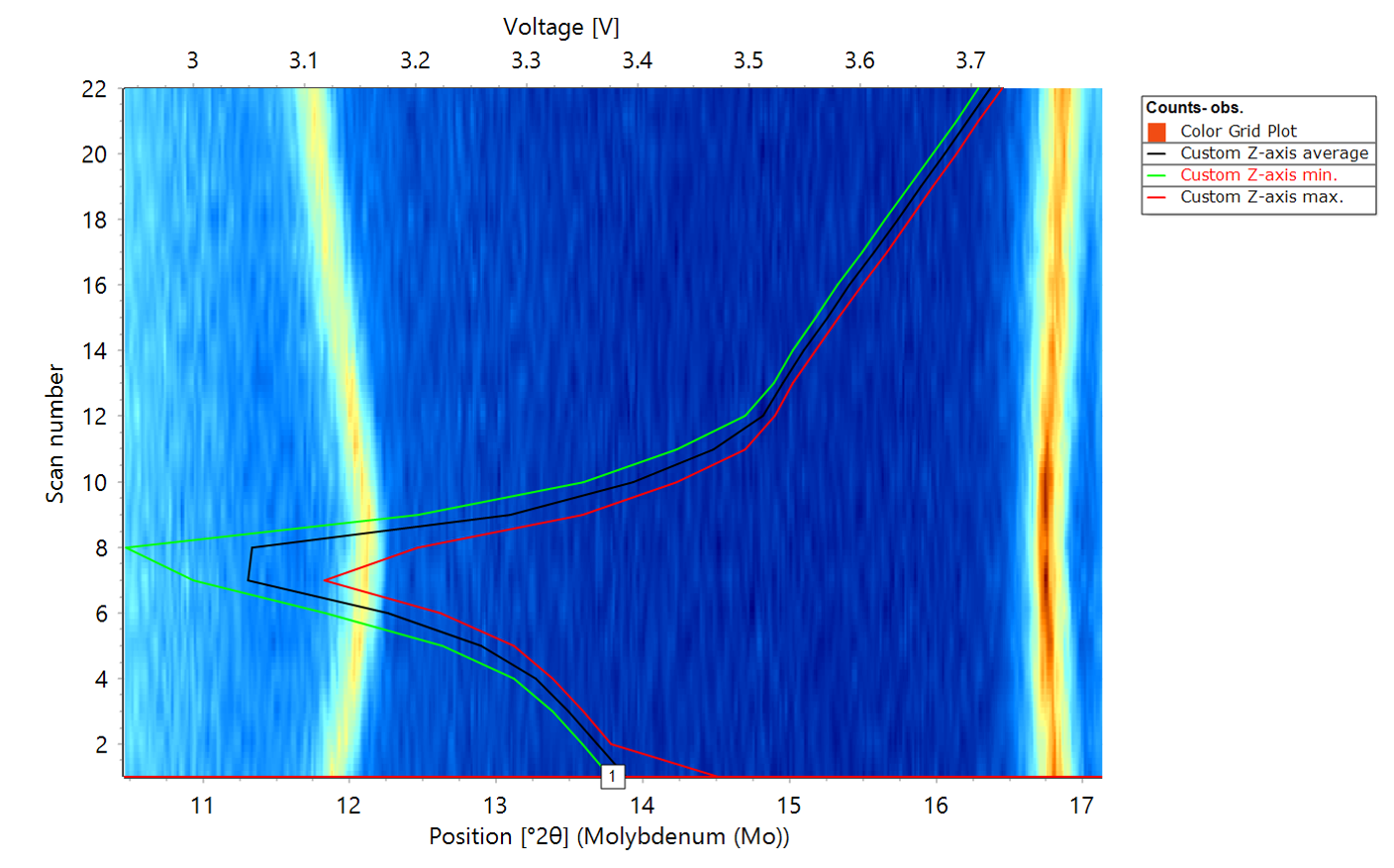

We produce graphics like in the attached plot with TChart, where we use a ColorGrid plus 3 Line Series.
Usually we display the Colors of the Color Grid in the Legend. Now we want in addition to show a legend for the 3 Line Series. But when we include the Line Series in the Legend the Color Grid colors are vanishing, see attachment.
How can we have the Color Grid colors Legend AND a Legend for the Line Series?

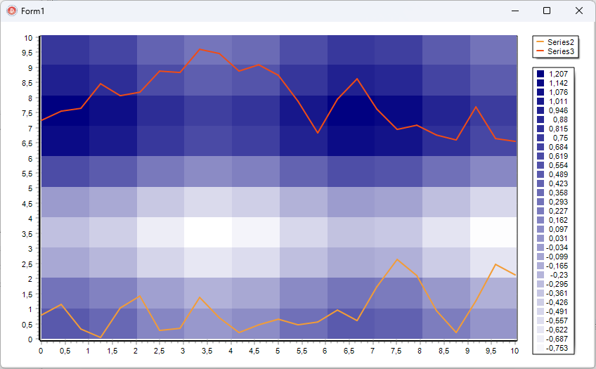

You could do something similar to the discussed here.
uses TeEngine, Chart, Series, TeeSurfa, TeeExtraLegendTool;
type TMyExtraLegendTool=class(TExtraLegendTool)
  protected
    procedure ChartEvent(AEvent: TChartToolEvent); override;
TLegendAccess=class(TChartLegend);
var Chart1: TChart;
procedure TMyExtraLegendTool.ChartEvent(AEvent: TChartToolEvent);
var i: Integer;
  if AEvent=cteAfterDraw then
    for i:=0 to ParentChart.SeriesCount-1 do
        ParentChart[i].ShowInLegend:=ParentChart[i] is TLineSeries;
    if Assigned(ParentChart) and Assigned(Series) then
      if Legend.Visible then
        TLegendAccess(Legend).CalcRect;
        Legend.DrawLegend;
procedure TForm1.Chart1BeforeDrawChart(Sender: TObject);
var i: Integer;
      Chart1[i].ShowInLegend:=Chart1[i] is TColorGridSeries;
var i: Integer;
  Chart1:=TChart.Create(Self);
  with Chart1 do
    Parent:=Self;
    Align:=alClient;
    Color:=clWhite;
    Gradient.Visible:=False;
    Walls.Back.Color:=clWhite;
    View3D:=False;
    OnBeforeDrawChart:=Chart1BeforeDrawChart;
  with TColorGridSeries(Chart1.AddSeries(TColorGridSeries)) do
    Pen.Hide;
    FillSampleValues;
  for i:=0 to 1 do
  with TLineSeries(Chart1.AddSeries(TLineSeries)) do
    Pen.Width:=2;
    FillSampleValues;
  Chart1.Draw;
  with TMyExtraLegendTool(Chart1.Tools.Add(TMyExtraLegendTool)) do
    Series:=Chart1[1];
    Legend.LegendStyle:=lsSeries;
    Legend.Left:=Chart1.Legend.Left;
    Legend.Top:=Chart1.ChartRect.Top;

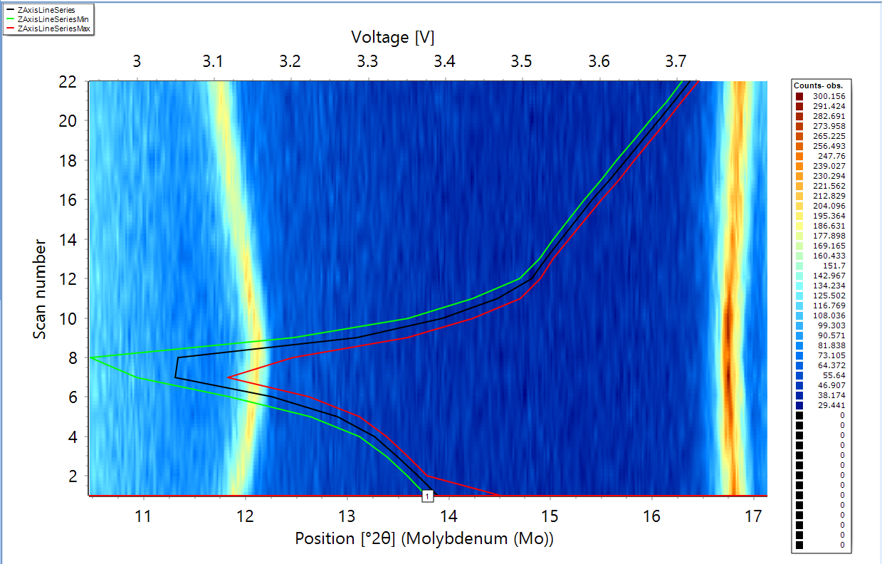

Thanks a lot, we are practically there:
I am setting the Position in the Create of the form but it looks like I need to update the position of the
extra legend before the painting.
One other quick question, how can I change/influence the texts that are shown in the Extra legend, I'd like to have other text than names of the Series?

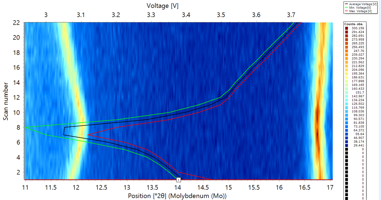

Ok, I just had to populate the Title properties of the Line Series, all perfect now, thanks!
