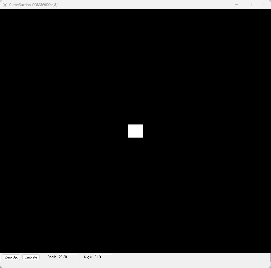

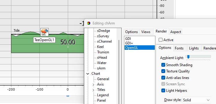

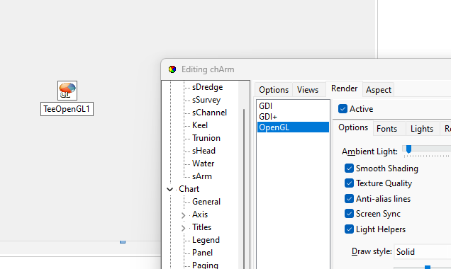

I am trying to use OpenGL 3D rendering and when I click the Activate button, the whole chart disappears. What am I doing wrong?
Screenshot 2024-09-23 141239.png (27.64 KiB) Viewed 88334 times
Screenshot 2024-09-23 141253.png (24.34 KiB) Viewed 88334 times

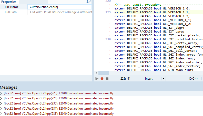

It is TChart Pro 2023, and RAD Studio (C++) 12.2. However, I have had this issue in previous versions as well. I usually just switch to GDI+, but I need to use lighting for this particular project. And, if I use OpenGL in Tee, then I cannot use it in the project itself. I get all types of errors (I have posted about this in the past) if I include "gl/gl.h."

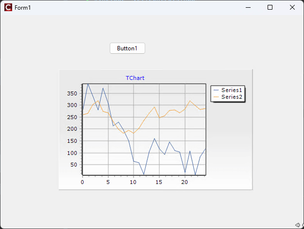

With TeeChart Pro v2024.41 and RAD 12.2, I've just created a new C++Builder project, added a TChart with a couple of TLineSeries and this TButton:
void __fastcall TForm1::Button1Click(TObject *Sender)
  Chart1->Canvas = new TGLCanvas();
And this to the .hpp:
#include <VCLTee.TeeGLCanvas.hpp>
And it seems to work fine for me here:

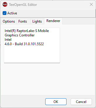

Unfortunately, my projects have many external references, so I would not be able to send you one. However, you are more than welcome to remote in if you would like. I am in the US Eastern time zone and here from 7:30 - 4:00 most weekdays. I did notice one interesting thing. I made a small DLL project and added a TChart with OpenGL and got the following information on the Renderer tab:
Screenshot 2024-09-25 115141.png (10.07 KiB) Viewed 88096 times

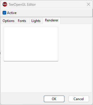

My project is blank:
Screenshot 2024-09-25 115053.png (7.39 KiB) Viewed 88096 times

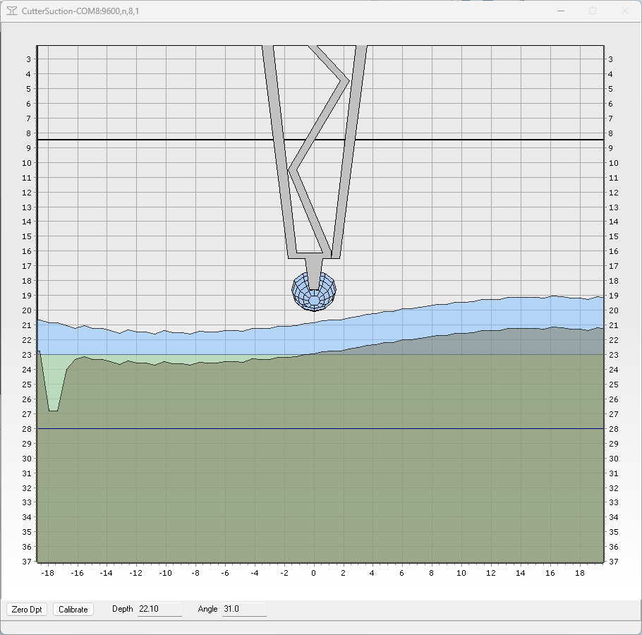

Well, I finally got it showing in Design mode. However, in runtime, it went from:
Screenshot 2024-09-25 125245.png (28.25 KiB) Viewed 88091 times
In GDI+
To a flickering black and white window in OpenGL. Is this because there is OpenGL being used in the main executable (remember, this is in a DLL).
