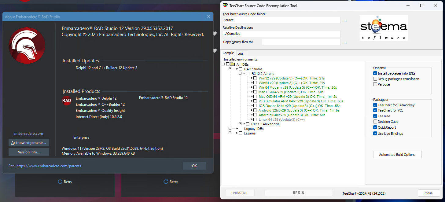

Re: RADStudio 12.3 support
Post by Yeray » Tue Mar 18, 2025 7:21 am
wrote:
Mon Mar 17, 2025 3:29 pm
If I use version with source code, TeeRecompile tool working correctly?
Yes, TeeRecompile shipped with TeeChart v2024.42 with source code builds and installs TeeChart correctly in RAD 12.3.
Does it see RAD Studio 12.3 IDE or is it required to build packages manually?
The label in the tree doesn't recognise the Update 3, but it works even if it says "RX12.2 Athens".

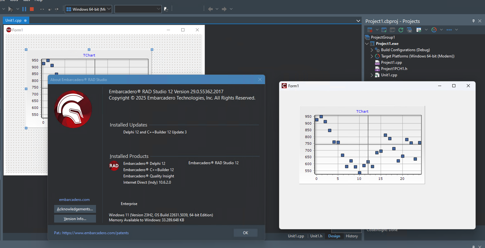

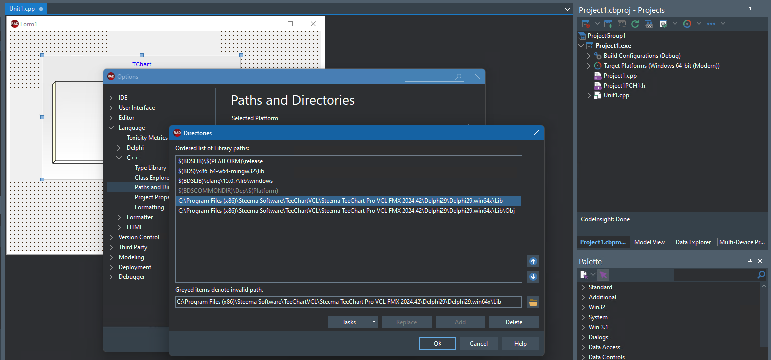

Post by Yeray » Tue Mar 18, 2025 8:52 am
That's strange, it seems to work fine for me here:
