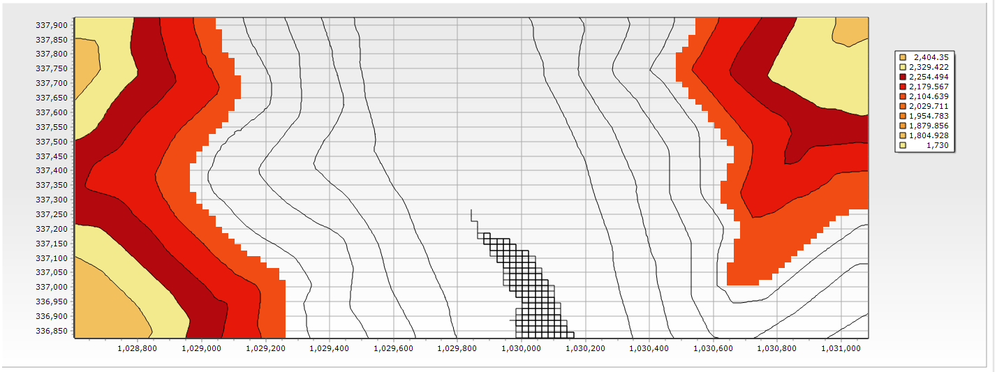

I am trying to contour elevations from a number of points.
For some reason the contour fill breaks up as shown in attached image.
If IrregularGrid := false then I get a blank grid.
Below is my code; I have excluded the query as it does not contribute.

Yeray, is your recommendation
a) to define the levels manually?
b) to assign the contour points to a surface?
c) ?
The link you provided mainly discusses a case where all the point values are the same (BTW has this fix been implemented? I run into a similar issue low performance issue a few months ago - but that is a different question)

I apologize if my previous explanation was not clear enough.
As you mentioned in your opening post, the code you provided is missing the actual data, which makes it impossible for us to pinpoint the exact issue. Without a simple yet complete example, it’s difficult to make an accurate guess about the problem.
In some cases, customers who encounter issues with 3D series tend to use highly irregular data to populate the series, which can lead to complications. This is why I directed you to an explanation regarding how data in TColorGrid and TSurfaceSeries should be structured for TeeChart to render it correctly.
I recommend trying to plot the same data using a TSurfaceSeries to check if it displays properly. Additionally, I would kindly ask you to share the data with us so we can examine it on our end as well.

I've received the data in an .xlsx file. I transformed it to a .csv and loaded to a chart as follows:

And it looks correct for me here:
Could you please try the code above in a new simple project to see if it also works fine for you?
