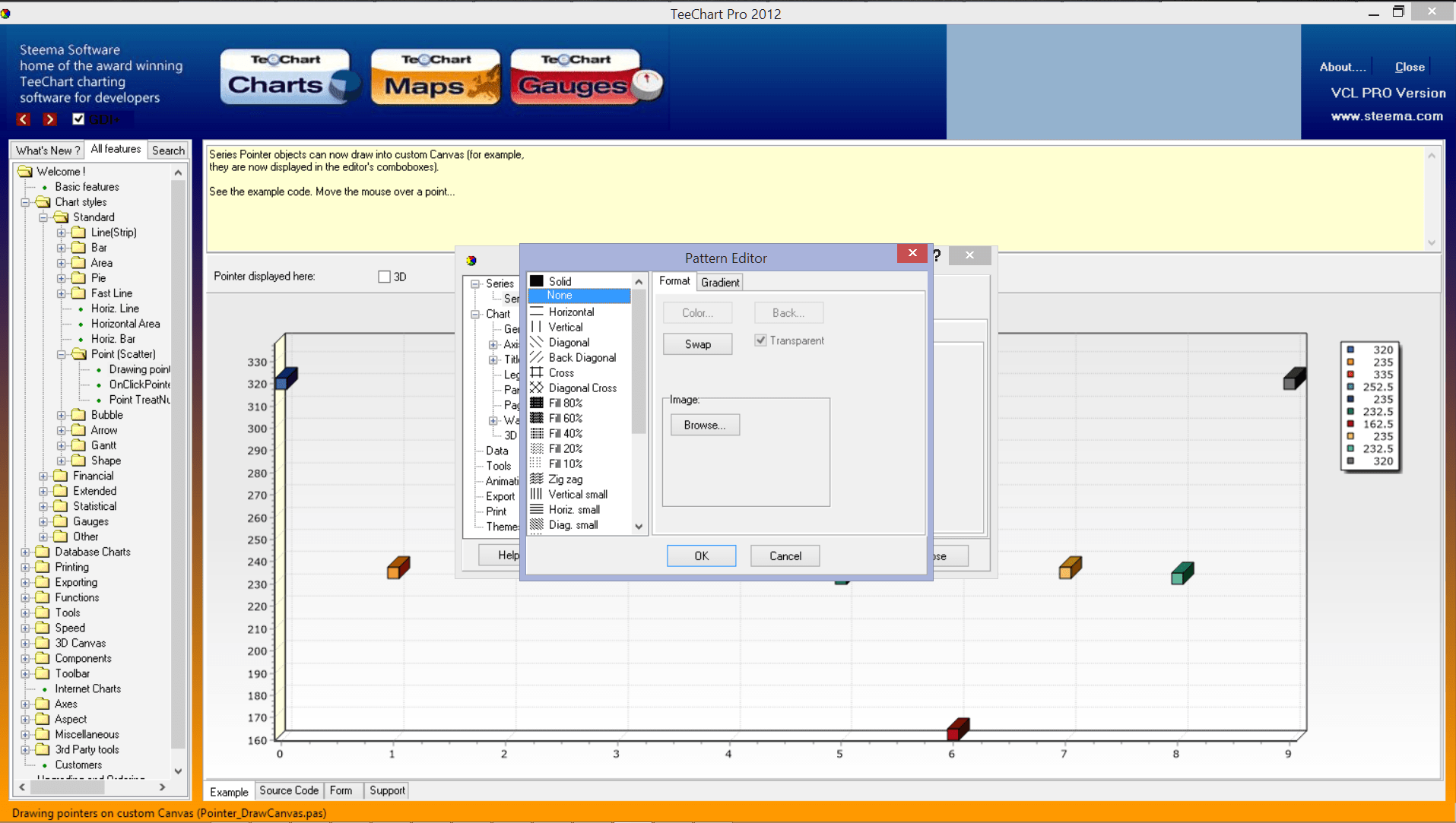

I'm afraid this feature isn't available now, at least at design time. I tried to achieve it by both Chart Editor and Object Inspector but out of success. To prove it I tried to do the same things in pre-compiled Tee8New and Tee9New demos. Is this expected feature change or a bug?

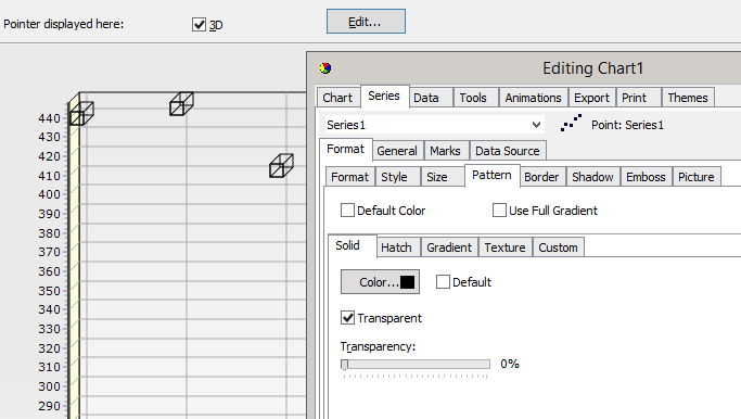

In the actual version, TeeChart v2015.14 I can achieve it both through the editor and by code:
- Through the editor, set the point to be transparent:
- By code, you can still do what Narcís pointed out above:

Thanks for the reply. My problem is I still use mainly Delphi 5 (although have older versions ups to XE2) due to need in Win9x users support. So the latest build I'm able to use is Build 2012.07.121105. And I have source code up to Build 2013.08.130521. May you give me a tip how to cope with this sort of problem>?
