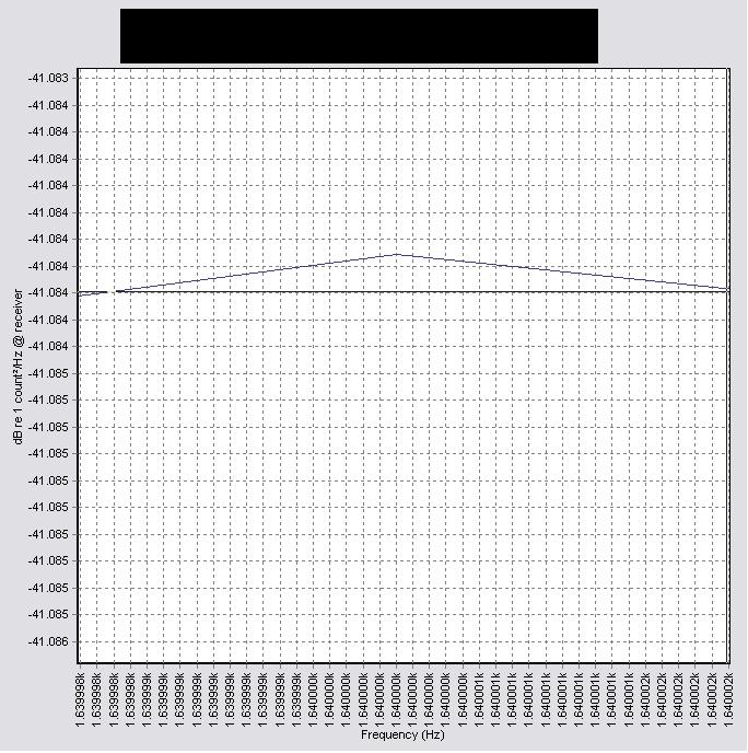

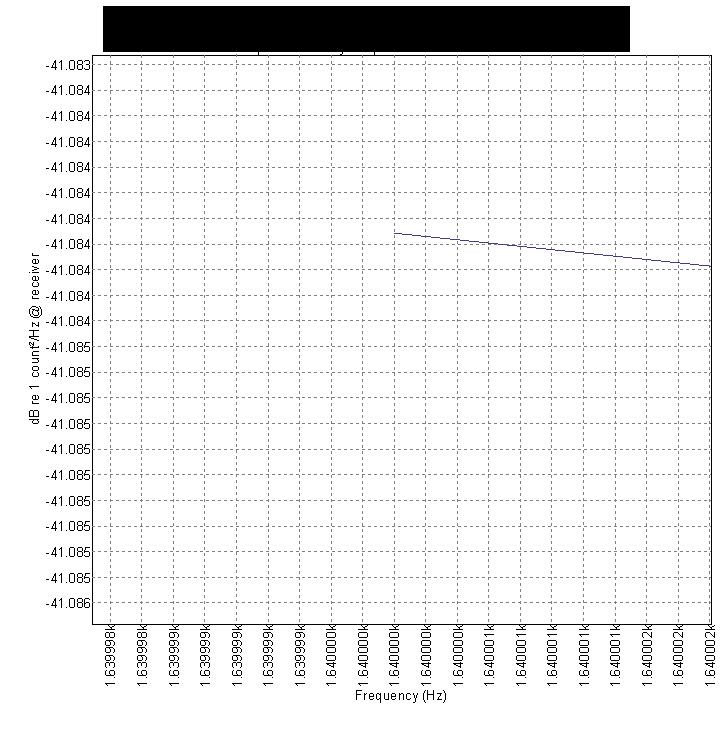

When "extreme" zooming in on a line plot to a single point (called B), and printing the plot, the printed version of the plot contains only a line from B to the next point (C, offscreen), and not the line from the previous point (A, offscreen) to B. This issue is actually visible in the TChartPreview component before printing.
In the attached files, the zoomed plot is a single point taken from a plot from 0-10000 on the X axis and -54 to 0 on the Y axis. The preview panel is a screenshot of the print preview based on the zoomed plot.

- the preview panel
- steema-2.JPG (98.71 KiB) Viewed 3946 times
- The zoomed plot
- steema-1.JPG (120.85 KiB) Viewed 3945 times
