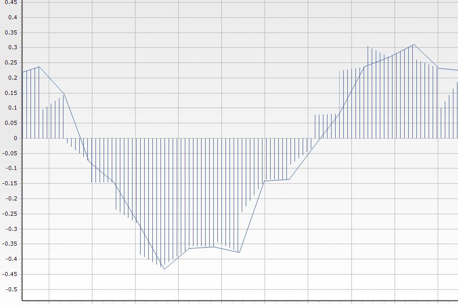

I have seriesregiontool associated with fastline series. This series has about 180000 points. When I display the whole series on the chart and set seriesregiontool.active=true, all looks good. But, when I zoom it very very close, I see that that the seriesregiontool fill is not following the series as shown in the attached image. I know its related to interpolation of points on the series by the seriesregiontool. How can i make sure the fill pattern of seriesregiontool exactly follows the series even at high zoom levels?

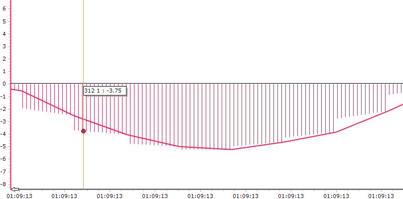

We reproduce your project and appears next image using last version 3 and version 4:
Please, you can say if this image is the same image that appears you? If is not please, you could explain as we do for reproduce exactly your issue.

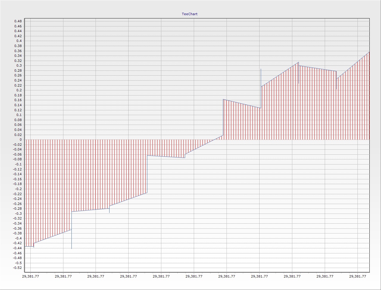

A further ivestigation revealed the following
The issue is with the .DrawAllPonts=false. Please set this property to the fastline series and try again with same project and data set.
Below is the image with the same dataset with drawAllPoints is set to false.
Re: SeriesRegionTool issues at high zoom level
Post by Sandra » Wed Oct 07, 2009 8:25 am
Hello asupriya,
I could reproduce your issue, and We considered very specific case.Why I have added in the wish-list with number[TF02014468]. If you want to work, put .DrawAllPoints=true.
