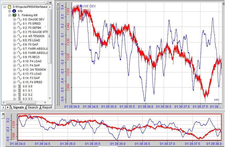

I am using teechart to make my historian trends. I have 2 charts, first one for full trend and second one for displays pan data from first one.
And I create a rectangle in first chart to get pan window. I want to display all data in pan window to show in second chart.
Has anyone got this code or has made the same with this issue?
Please, help me.
Thanks in advance!
Please, see the attach file

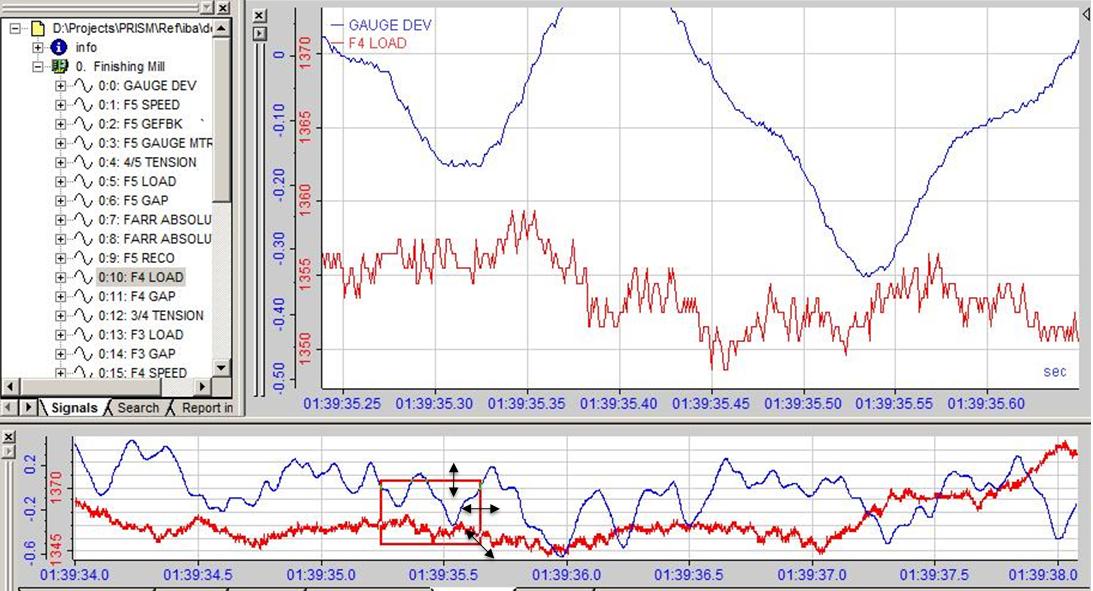

Your sample is very nice. But I want to create pan window by RECTANGLE because I want to DRAG and RESIZE on both side (Vertical, Horizontal, Both).
Could you please help me?
Please, see the attach image!

In that case you should do something similar to the above but you could use a RectangleTool that allows dragging and resizing in all directions. And you should also do a SetMinMax for the left axis too. Here is an example:
            InitializeChart();
        FastLine fast1, fast2;
        RectangleTool rectangle1;
            tChart2.Aspect.View3D = false;
            tChart2.Legend.Visible = false;
            fast1 = new FastLine(tChart1.Chart);
            fast2 = new FastLine(tChart2.Chart);
            fast1.FillSampleValues(200);
            fast2.DataSource = fast1;
            rectangle1 = new RectangleTool(tChart2.Chart);
            rectangle1.Shape.Pen.Color = Color.Red;
            rectangle1.Shape.Transparency = 50;
            rectangle1.AllowDrag = true;
            rectangle1.AllowResize = true;
            rectangle1.Dragging += new RectangleToolDraggingEventHandler(rectangle1_Recalc);
            rectangle1.Resizing += new RectangleToolResizingEventHandler(rectangle1_Recalc);
            rectangle1.Left = 50;
            rectangle1.Top = 50;
            rectangle1.Width = 100;
            rectangle1.Height = 100;
        void rectangle1_Recalc(object sender, EventArgs e)
            tChart1.Axes.Bottom.SetMinMax(tChart2.Axes.Bottom.CalcPosPoint(rectangle1.Left), tChart2.Axes.Bottom.CalcPosPoint(rectangle1.Left + rectangle1.Width));
            tChart1.Axes.Left.SetMinMax(tChart2.Axes.Left.CalcPosPoint(rectangle1.Top + rectangle1.Height), tChart2.Axes.Left.CalcPosPoint(rectangle1.Top));

How can I set the area limitation of rectangle only in DATA AREA like below image?
(If I don't set limitation the rectangle will exceed DATA AREA when I drag or resize)
Could you help me?
Thank you very much!
