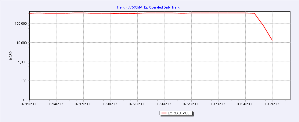

I used the code
Chart1.Axes.Left.Logarithmic = true;
to show chart with logarithmic, but the chart is way over the top (see attached chartLogarithmic), how can I let the chart display in center?
Thanks ahead
Re: How to make logarithmic chart to center
Post by Sandra » Tue Aug 11, 2009 10:05 am
Hello Beige,
...but the chart is way over the top (see attached chartLogarithmic), how can I let the chart display in center?
I recomend that adjust left axes using SetMinMax(minValue,maxValue). Please see next simple example, and check if is that you want do.
        Steema.TeeChart.Styles.Line line1;
            line1 = new Steema.TeeChart.Styles.Line(tChart1.Chart);
            line1.FillSampleValues(100);
            line1.Color = Color.Red;
            line1.LinePen.Color = Color.Red;
            line1.LinePen.Width = 2;
            tChart1.Axes.Left.SetMinMax(10, 10000);
