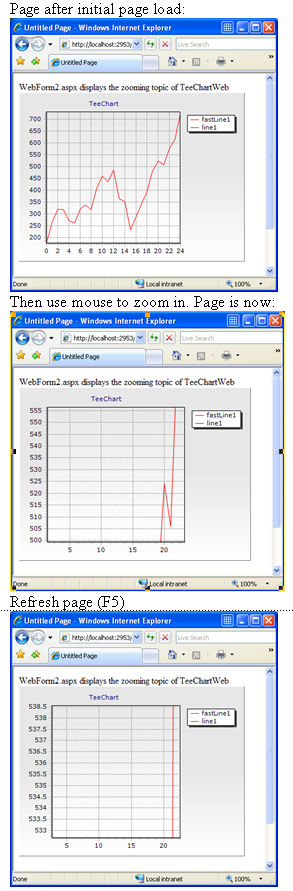

Thanks Sandra,
I also tried to use the SetCurrentZoom overload you used in your reply. The chart is zooming, but one problem still occurs:
* If I zoomed in in the chart displayed in the Web browser, and I refresh the page, the zoom action is performed again on the already zoomed graph!!
This causes the graph to be zoomed in further on every page (graph) update.
The actions I do:
* Load the page
* Manual zoom in an area with the mouse
* update the page (F5) to retrieve new data (xAxis and Yaxis are now zoomed in further!!)
Here some screenshots:
Screenshots
I want the zoomed area to be the same after the page refresh. How can I do this?
Thanks in advance

Post by Sandra » Fri Aug 14, 2009 11:17 am
Hello marcoIpcos,
TeeChart's WebChart is connectionless to the server so all information describing the zoom is carried with the current page as a session variable. The problem as you have found is that a page refresh resends the zoom request incrementing that zoom on the current zoom whose information is stored with the page.
An option would be to remove the memory of the current zoom when refreshing, that is a very workable option if you are satisfied that one depth level of zoom for your application users is enough (as all zooms will act upon the unzoomed 'stock' Chart).
