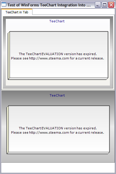

The background behind the title in the first chart should not be solid white. In order to make this more noticeable, please change the XAML to the following:
<Window x:Class="WpfApplication1.Window1"
  xmlns="http://schemas.microsoft.com/winfx/2006/xaml/presentation"
  xmlns:x="http://schemas.microsoft.com/winfx/2006/xaml"
  xmlns:teechart="clr-namespace:Steema.TeeChart;assembly=TeeChart"
  Title="Test of WinForms TeeChart Integration Into WPF App" Height="600" Width="400">
  <StackPanel>
    <TabControl>
      <TabItem Header="TeeChart in Tab">
        <WindowsFormsHost><teechart:TChart x:Name="Chart1"/></WindowsFormsHost>
      </TabItem>
    </TabControl>
    <WindowsFormsHost><teechart:TChart x:Name="Chart2"/></WindowsFormsHost>
  </StackPanel>
</Window>
And add the following code-behind:
  public partial class Window1 : Window
    public Window1()
      Chart1.Panel.Gradient.StartColor = System.Drawing.Color.Gray;
      Chart1.Panel.Gradient.EndColor   = System.Drawing.Color.Silver;
      Chart2.Panel.Gradient.StartColor = System.Drawing.Color.Gray;
      Chart2.Panel.Gradient.EndColor   = System.Drawing.Color.Silver;
And don't forget to reference System.Drawing.

Walt
Posts: 35
Joined: Wed Aug 17, 2005 4:00 am
Location: San Jose, CA
Re: ColorGrid Buggy in WPF Demo App
Post by Walt » Thu Aug 13, 2009 10:59 pm
Sorry for the late reply. Below is what I get. Maybe this is a weird video-card issue or something? This only happens with the WinForms control (not the WPF version), but I need to use the WinForms version in order to have access to the editor (and maybe other reasons). No matter what settings I change, I can not get rid of the white box behind the plot area and chart title. I am using .NET 3.5 SP1 (and VS2008 SP1).
WPF integration issue.
WPF Integration Bug.png (20.02 KiB) Viewed 15326 times
