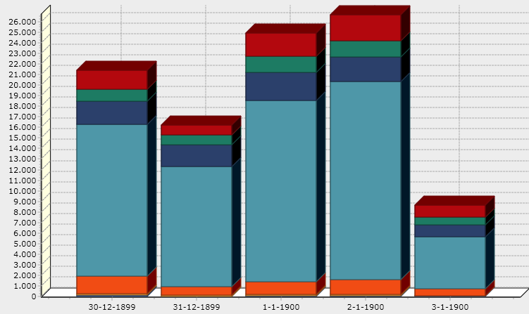

Hello, When i want to show a datetime object on the x-axis, it starts at 1899.
See the attachment how it looks.
Source code looks like this.
ObservableCollection<Gensys.Widget.ObjectsAndMessages.ObjectsAndMessagesModel.MessageData> col = new ObservableCollection<ObjectsAndMessagesModel.MessageData>();
Steema.TeeChart.WPF.Styles.Bar barSeries;
tchart.Chart.Series.Add(barSeries = new Steema.TeeChart.WPF.Styles.Bar());
barSeries.XValues.DateTime = true;
barSeries.XValues.DataMember = "Date";
barSeries.YValues.DataMember = "TotalTickets";
int counter = 0;
List<MessageData> messageData = _objectsAndMessagesModel.MessageList.Where(m => m.Date == time).ToList();
foreach (MessageData data in messageData)
barSeries.Add(data.TotalTickets);
barSeries[counter].Color = GetMessageTypeColor(data.MessageType);
counter++;
col.Add(data);
barSeries.DataSource = col;
I bind to the date property that is located inan other class, but the datacontext is set to an instance of that class and the datasource is set to the observablecollection where data is located.
How can i fix this?
the barchart is selfstacked btw.

thank you for your reply, but i dont think thats the answer, because when i change the multibar to stacked or something else then selfstack, then the x-axis will show the correct dates. But i want i to be set at selfstack. I think it is a bug when using the selfstack option

I've tried to reproduce it with the following code but coudln't:
            //tChart1.Aspect.View3D = false;
            for (int i = 0; i < 5; i++)
                new Steema.TeeChart.WPF.Styles.Bar(tChart1.Chart);
                tChart1[i].XValues.DateTime = true;
                tChart1[i].FillSampleValues(5);
            Steema.TeeChart.WPF.Styles.Bar bar1 = tChart1[0] as Steema.TeeChart.WPF.Styles.Bar;
            if (bar1.MultiBar == Steema.TeeChart.WPF.Styles.MultiBars.Stacked)
                bar1.MultiBar = Steema.TeeChart.WPF.Styles.MultiBars.Side;
                bar1.MultiBar = Steema.TeeChart.WPF.Styles.MultiBars.Stacked;
Could you please modify it until the problem can be reproduced? Or could you send us a simple example project we can run as-is to reproduce the problem here?
