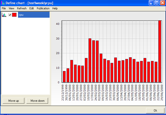

I've downloaded and installed the new build but unfortunately it doesn't really do any thing to resolve this issue.
My original chart with weekly increment set and data starting on 26Dec shows labels not aligned to bars

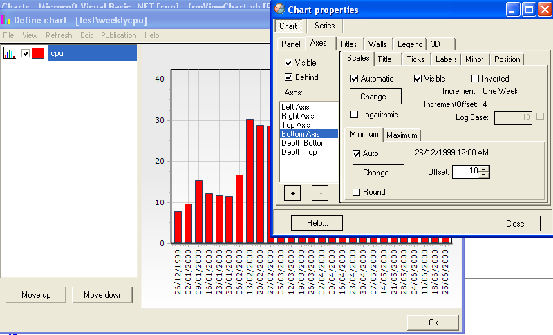

If I change the new offset value to 4 the labels are aligned.

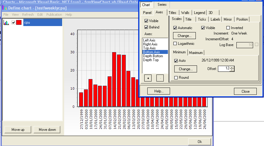

However If I make the window just a tiny bit bigger then the labels are wrong again.
I really think the way to resolve this is the have tchart start the labeling with the first value from the data. so if the first date is 26Dec then the first label should be 26dec then the second label is 7 part the first etc.

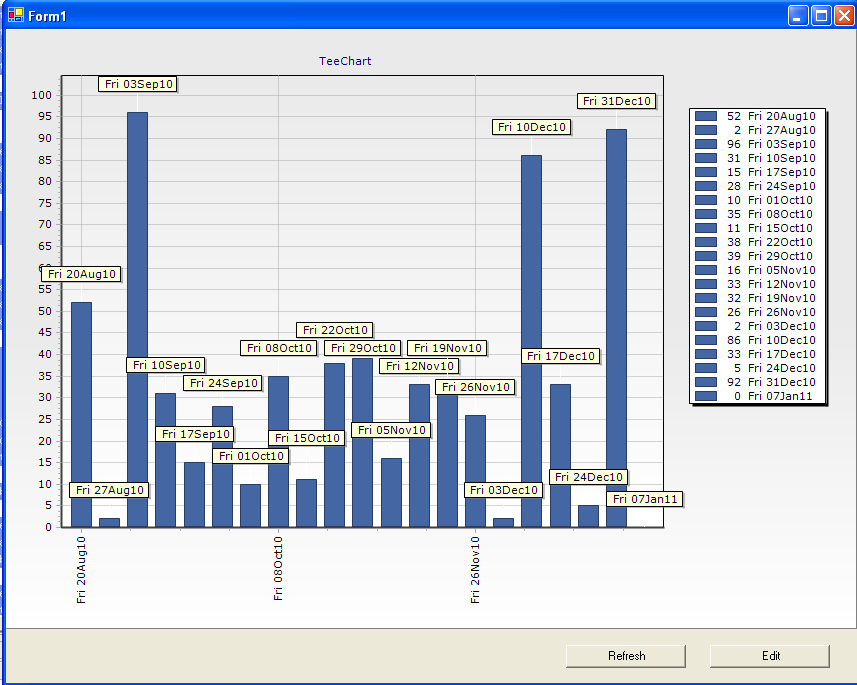

06-08-2010 05-04-55.png (7.14 KiB) Viewed 154371 times
It shows the left most bar with a label of 27 Dec, all be it slightly misaligned but never the less the bar has a label showing the 27th Dec. This is plainly wrong as the true date for this bar is the 26th. This wouldn't be a problem so much if the series was a line series as line series are used to show continuous data. It's generally the shape of the entire line that is of interest and people understand that they must drop down from the point of interest on the line to the axis and infer what date it relates to. Bars are different in that they are used to show discrete observations with the label under the bar being (in our case) the date at which that discrete observation occured. Looking at the example above most (if not all) people would assume that the bar is for the 27th Dec when in fact it's for the 26th.

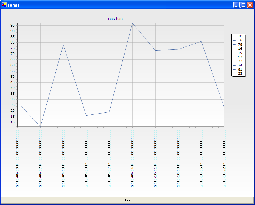

I am looking at ways I can get my application to automatically assign custom label values when an axis is Datetime and a standard increment has been set but I really think tchart should be doing this automatically.
 Private Sub InitializeChart()
      TChart1.Clear()
      TChart1.Aspect.View3D = False
      Dim Line = New Steema.TeeChart.Styles.Line(TChart1.Chart)
      Line.XValues.DateTime = True
      TChart1.Axes.Bottom.Labels.DateTimeFormat = "yyyy-MM-dd ddd HH:mm:ss.fffffff"
      TChart1.Axes.Bottom.Increment = Utils.GetDateTimeStep(DateTimeSteps.OneWeek)
      Dim rnd = New Random
      Dim dte = New DateTime(2010, 8, 20, 0, 0, 0, 0)
      Dim y As Double
      For i As Integer = 0 To 9
         CType(Line, Steema.TeeChart.Styles.Line).Add(dte, rnd.[Next](100))
         dte = dte.Adddays(7)
      Next
   End Sub
produces the following chart

Ok accepted that everything conforms to the design paradigm but what about the situation in the example where the label under the bar is plainly wrong.

Captell wrote:Ok accepted that everything conforms to the design paradigm but what about the situation in the example where the label under the bar is plainly wrong.
It is *apparently* wrong, not plainly wrong :) . Think that the actual XValue of the Bar is the *middle* of the Bar. Following the *middle* of the Bar down to the bottom axis and extrpolating the value by eye, I would say that it probably does fall on the 26th. The label of the 27th clearly does *not* fall in the middle of the Bar and so is *not* the XValue the Bar represents.

It is *apparently* wrong, not plainly wrong . Think that the actual XValue of the Bar is the *middle* of the Bar. Following the *middle* of the Bar down to the bottom axis and extrpolating the value by eye, I would say that it probably does fall on the 26th. The label of the 27th clearly does *not* fall in the middle of the Bar and so is *not* the XValue the Bar represents.
I understand that but, the normal use of a bar chart is to look at the label at the bottom of the bar. Most users looking at the example will assume that the bar is for the 27th not the 26th, to expect them to know how the tchart labels work and that they should only take the label on face value if it falls exactly at the centre point bar is a bit of a stretch, don't you think?

Captell wrote:I understand that but, the normal use of a bar chart is to look at the label at the bottom of the bar. Most users looking at the example will assume that the bar is for the 27th not the 26th, to expect them to know how the tchart labels work and that they should only take the label on face value if it falls exactly at the centre point bar is a bit of a stretch, don't you think?
If that is your opinion that I would suggest that you either:
  • 1) Use automatic axis labels in conjunction with series marks.
    2) Use manual axis labels.

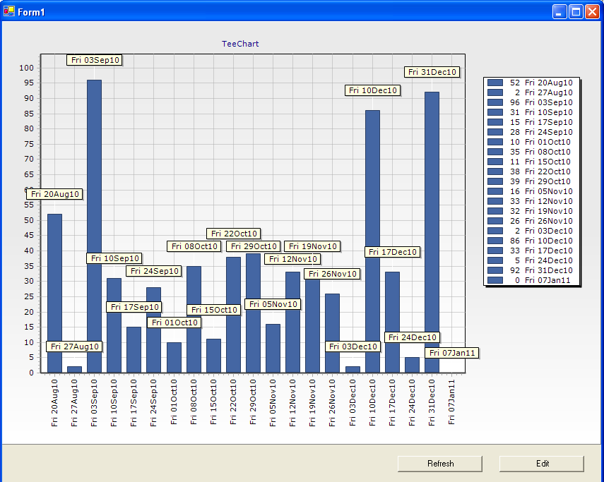

Posts: 65
Re: X asix labels not lining up properly
Post by Captell » Sat Aug 07, 2010 11:10 pm
Hi Christopher,
I'm trying to implement a solution to this issue using custom labels but am running into some more issues. Im using the following code

      bar.XValues.DateTime = True
      TChart1.Axes.Bottom.Labels.DateTimeFormat = "ddd ddMMMyy"
      Dim y As Double
      For i As Integer = 0 To 20
         CType(bar, Steema.TeeChart.Styles.Bar).Add(dte, rnd.[Next](100), CDate(dte).ToString("ddd ddMMMyy"))
      Next
   End Sub
   Private Sub Button1_Click(ByVal sender As System.Object, ByVal e As System.EventArgs) Handles Button1.Click
      TChart1.ShowEditor()
   End Sub
   Private Sub btnRefresh_Click(ByVal sender As System.Object, ByVal e As System.EventArgs) Handles btnRefresh.Click
      InitializeChart()
   End Sub
End Class
which results in the following chart
which on the face of is seems to resolve my problem however if I resize the window slightly with the mouse I get the following
Most of the labels dissapear. I'm really hoping to be able to resolve this issue this week by using something simmilar to the sample code, I'll just detect whether the axis is datetime and if so apply custom formatting. It should all work correctly apart from this strange behaviour when resizing. The problem also sometimes appears when the chart is first displayed, i.e. without first resizing.
Any suggestions.
Adrian.

A little more information, The problem with the dissapearing labels only seems to occur if there are 15 or more bars, less than 15 bars and the problem dosen't appear.

Since you are adding the points with label, and you are showing it in the Bottom axis, you don't need to set any Increment and you won't probably need to add the points with XValue.
This works fine for me here:
            Steema.TeeChart.Styles.Bar bar = new Steema.TeeChart.Styles.Bar(tChart1.Chart);
            bar.XValues.DateTime = true;
            tChart1.Axes.Bottom.Labels.DateTimeFormat = "ddd ddMMMyy";
            //tChart1.Axes.Bottom.Increment = Steema.TeeChart.Utils.GetDateTimeStep(Steema.TeeChart.DateTimeSteps.OneWeek);
            Random rnd = new Random();
            DateTime dte = new DateTime(2010, 8, 20, 0, 0, 0, 0);
            for (int i = 0; i < 20; i++)
                //bar.Add(dte, rnd.Next(100), dte.ToString("ddd ddMMMyy"));
                bar.Add(rnd.Next(100), dte.ToString("ddd ddMMMyy"));
                dte = dte.AddDays(7);
However I think adding the points with DateTime XValue shouldn't cause problems here. I've added it to be investigated for future releases (TF02015083).

My application allows the user to use the chart editor to set properties on axes and other stuff in the chart. They also get to set what data is plotted, i.e. they set up their own database queries and then chart the resultant data. As the "problem" with the axes lables not lining up on bar charts is forcing me to manually add the labels I think don't think we can ignore the increment setting.
The users will naturally set the increment when they create a bar chart, just like they do when they create a line chart. Can this be added to the list of things to look at please. I'd also like to see these issues looked at with some degree of urgency. At the moment I have users creating bar charts where the label under the bar (ok not directly centered under the bar but never the less under the bar) is not the actual date of the data represented by the bar.
