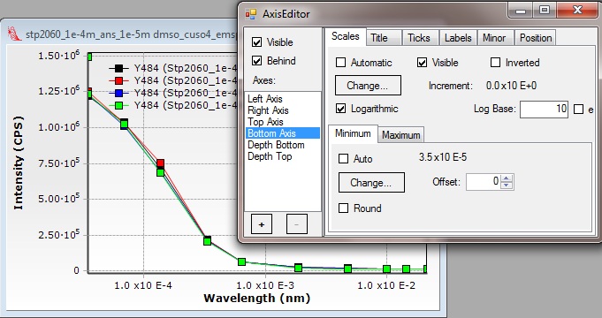

In the next image (test4a.jpg) the label format is '#.0 "x10" E+0' (another preset offered by the chart editor). Here the Steema chart editor and the TChart interpretes it as
"10e-2" = 1e-2. (this is the correct value for the label near axis.bottom.maximum)
So I did, and my colleagues did, too.

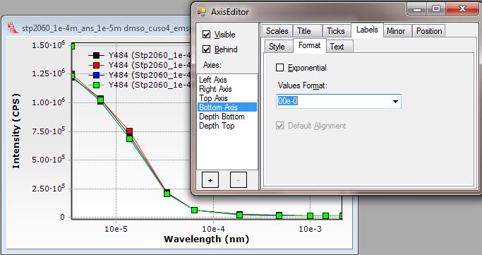

And now I changed the formate string to "00e-0" (test4b.jpg):
It seems to be very clear: such ambiguity must be avoided.
So I really think labelling has to be enhanced. It's not consistent. Such behavior must lead to confused end users. End users sometimes tend to look not as sharp as required.

I don't agree with you: From my point of view, correct auto scaling has to include the following:
(1) setting axis minimum, maximum and interval in accordance with the data to present
(2) unambiguous label formatting (preferably, it could be presentation ready)
(3) only points with values in the min/max range have to be displayed
The TeeChart code does not fulfill these requirements with respect to logarithmic axes. It's not imported for me whether it is by design or not. It is a bug in my eyes. If you say that is "by design" then - that is my view concerning trustworthy software - you have it to declare and to protect the user towards the possibility of presenting wrong data. And in your description and documentation of TeeChart I nothing read about this.
I think you forget:
(4) only data which is mathematically real should be handled automatically. Log(0) is not a mathematical reality.
TeeChart does not throw anything anywhere near an unhandled exception when non-real data (Log(0)) is added to the chart. What is more, getting TeeChart to handle non-mathematically real data in this instance is *one line of runtime code*.
One cannot demand that the user is familiar with the MS specifications of format strings.
Yes, one can. TeeChart for .NET runs in the Microsoft .NET Framework and so it is perfectly natural to expect people working in it to be familiar with MS specifications.

That's not true: There is no data value with log(0) in the chart! So TeeChart has to handle all data points!!! Possibly you did not understand the problem?
No. You can demand it from the programmer using your chart control, but you can't demand it from the end user working with the final application. He often will possibly never have heard anything about .NET. And when this end user works with Teechart editor no programmer can prevent him to do crazy things - only TeeChart code and his editor can do this. Possibly you have not really tried to understand my explanations?
I honestly can't see how accusing me of not understanding what you write is in any way helpful to this discussion.
The TeeChart Editor is designed to handle stopping the end user doing "crazy" things. What it isn't designed to do is to accept whatever the end user adds to it as valid input. At the moment, the TeeChart Editor handles the format strings that it does. If you would like it to handle some more, please give me an exhaustive list of the ones that you want it to handle.
And even this issue is not really fixed. It should work with any valid format string, and it does not. It even works not correctly with this string included in the corresponding chart editor combobox. I think one can expect that after programming or fixing any object the programmer checks the full functionality of that object carefully. Here it was not done.
It is obvious that what you and I consider as a valid format string are two different things. As I said above, if you'd like TeeChart to accept format strings other than the ones that TeeChart presently accepts, please post an exhaustive list here (or give us a URL to one).
