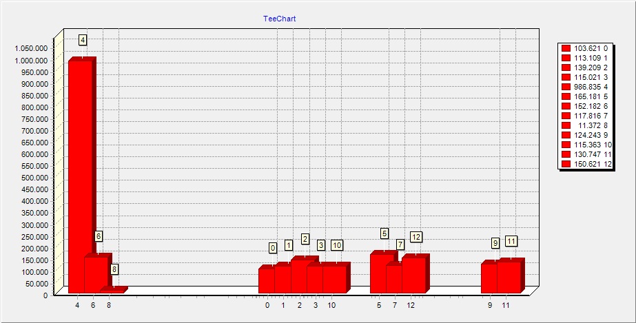

Using code above with latest TeeChart for .NET v2 release available at the client download area I got this chart:
As can be seen in bars marks, they are not sorted. Do you get the same at your end? Are you using latest v2 release available?

thank you for your reply. However, the values in your example are sorted though.
The first bar for example has value greater that 900 which correspondes to array element
with x value that is equal to 0001621. And this bar should be fifth bar on the graph.
I am not sure if I was clear , but I need the values to be displayed in exactly the same order as they are stored in the array.

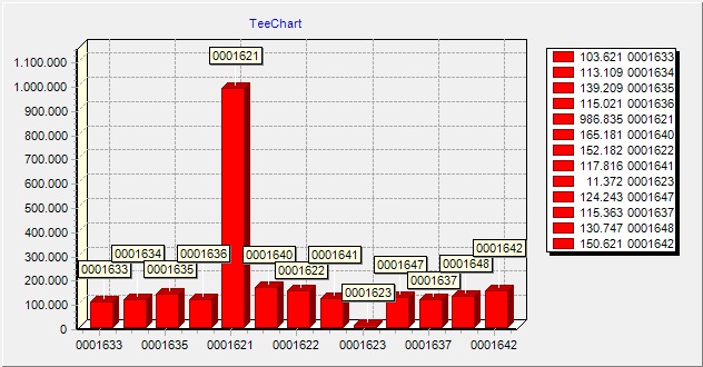

Yes, I understand now what you mean but what I get I think it's correct as you are populating series using those values as X values, they are not sorted but plotted at the X position corresponding to the X value you provided. To get what you request you shouldn't use those values as X values, just use them as points labels and let series automatically use sequential X values replacing points.Add() call in previous example for this:
        points.Add(dslagmass, response[i][0].ToString());
Which produces the chart below. Is that what you were looking for?
BTW: If that's what you need then it's not necessary to set XValues.Order to none either.

Thank you Narcis!
It is exactly what I need. :) :) :) It works now. Thank you very much.
