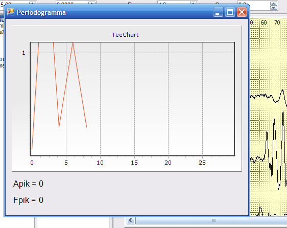

After added this series we have
It is obvious that point (2;0.1) must be below the point (6;0) because 0.1> 0. It is bug.

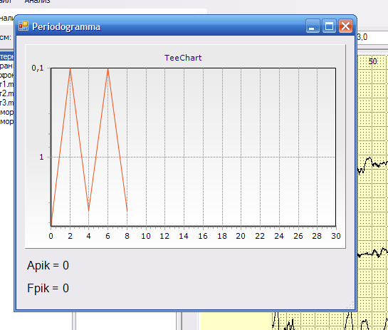

After moving this graph (right mouse button is pressed), we get correct graph

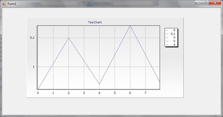

I have achieved next image:
In image you can see that the points are drawn correctly, if you look for example at 0 it is painted above of 0.1 and as left axis is inverted it is correct. So in my opinion property of axes logarithmic, works fine for me. If you think that is not correct for you, please explain exactly why, so we can help you in this.

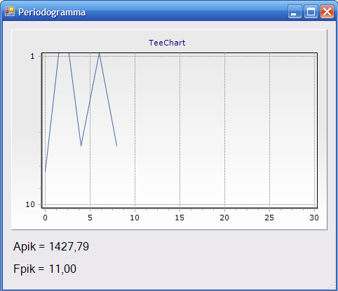

Dear Sandra, the example that you sent is really working. But then we apply true value to the parameter tChart1.Axes.Left.AutomaticMinimum the drawing becomes incorrect (Fig.1)
You have to agree that it should work correctly with any value of this parameter. Besides when we scroll the chart up (dragging with right mouse button) the drawing also becomes incorrect (Fig. 2). Please test this more thoroughly.
