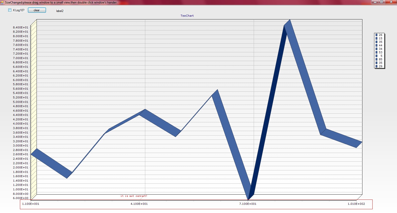

I want to realize fellow function using Tchart version:3.5.3225.32185:
when user change the chart window's size,the axis's label can adjust their visible when all labels are custom label.
My Axis's label can't adjust its label's visible when the chart window's size have been changed.The axis's labels will overlap and it is unacceptable!
please look this attachment.
The custom label is added like this:
double x=0;
AxisLabelItem xLabel = tChart1.Axes.Bottom.Labels.Items.Add(Convert.ToDouble(x.ToString("E3")));
                    xLabel.Transparent = true;
                    xLabel.Width = 90;
                    xLabel.Value = x;
for example: the x-axis labels:0.00,1.00,2.00,3.00,4.00,5.00,6.00,7.00,8.00,9.00,10.00.
All label will displayed when max window status,but when user change the chart window's size,there should be only show 0.00,2.00,4.00,6.00,8.00,10.00,The other label should be hidden.
I know the Feature list have realize this function,but my project can't and I don't know what causes this.
I want to know:How can I realize this?Is there have something effective for this or a property can do this?

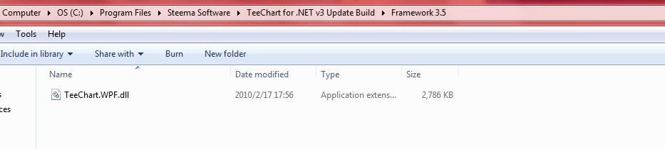

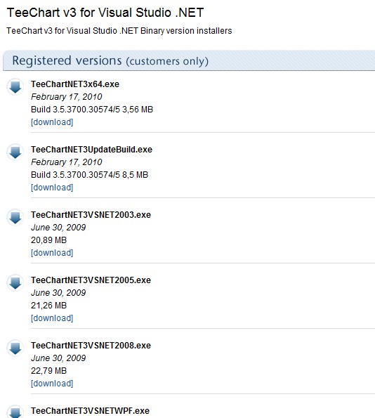

I have download all version and installed,but I didn't found the last version: 3.5.3700.
In TeeChartNET3UpdateBuild file,there is no Tchart.dll for .net3.5(3.jpg),but my project is .net3.5.Can we user tchart.dll for .net2.0?
I have upload the list version in my customer page(1.jpg),please tell me which file is the last version,thanks?
Yes, you can use .net2.0 dll without problems, in your projects made in .net3.5
In the customer page you can see TeeChartNET3UpdateBuild, this is the last version 3 update of Febrary, 2010, but before download and Install the update, you need download last version 3 of June, 2009 that in your case you need download TeeChartNet3Vnet2008 and install it. After you can install the TeeChartNet3UpdateBuild

I have resolve this like this:
   //the current Label  will be hidden when it is overlapped with its previous labels.
            //Get the axis
            Steema.TeeChart.Axis xAxis = tChart1.Axes.Bottom;
            Steema.TeeChart.Axis yAxis = tChart1.Axes.Left;
            xAxis.Labels.Items[0].Visible = true;
            string visibleInfo =  xAxis.Labels.Items[0].Text+":true"+Environment.NewLine;
            for (int i = 1; i < xAxis.Labels.Items.Count; i++)
                var currentLabel = xAxis.Labels.Items[i];
                SizeF currentSize = tChart1.Graphics3D.MeasureString(xAxis.Labels.Font, currentLabel.Text);
                Rectangle currentRect = new Rectangle(xAxis.CalcXPosValue(currentLabel.Value), xAxis.CalcYPosValue(currentLabel.Value), (int)currentSize.Width, (int)currentSize.Height);
                AxisLabelItem lastVisibleLabel = xAxis.Labels.Items.Where(x => x.Visible && IndexOfLabel(xAxis, x.Text) < i).LastOrDefault();//get the nearest visible Label before current Label
                if (lastVisibleLabel == null)
                    currentLabel.Visible = true;
                    continue;
                SizeF lastVisibleSize = tChart1.Graphics3D.MeasureString(xAxis.Labels.Font, lastVisibleLabel.Text);
                Rectangle lasyVisibleRect = new Rectangle(xAxis.CalcXPosValue(lastVisibleLabel.Value), xAxis.CalcYPosValue(lastVisibleLabel.Value), (int)lastVisibleSize.Width, (int)lastVisibleSize.Height);
                if (lasyVisibleRect.X + lastVisibleLabel.Width >= currentRect.X)
                    currentLabel.Visible = false;
                visibleInfo += xAxis.Labels.Items[i].Text + currentLabel.Visible + Environment.NewLine;
  tChart1.Update();
       private int IndexOfLabel(Axis axis, string p)
            var labelArray = axis.Labels.Items;
            for (int i = 0; i < labelArray.Count; i++)
                if (labelArray[i].Text == p)
                    return i;
            return -1;

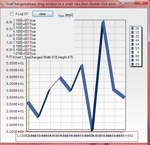

but this will refresh chartView twice,because I have Refresh after AfterDraw event!I did use AfterDraw event because the tChart1.SizeChanged() and tChart1.Resize() can not Calc correct XPosValue and Calc correct YPosValue.
I have uplaod my test project,please check this.
AfterDraw(),SizeChanged() and Resize() have been contained in this project.
please run project ,drag window to a small window,then double click window's hander to maximize window(2.jpg),the Labels don't adjust correctly for SizeChanged() and Resize() .
And then double click window's hander to restore the small window status(3.jpg),the Labels don't adjust correctly for SizeChanged() and Resize().
I don't know what happened.
do you know why SizeChanged and Resize can not do this or there have any other event can do this and not refresh ChartView twice?thanks.
