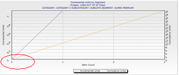

I'm using Steema Silverlight. My Left Y Axis Starts from Zero and Bottom Axis also starts from Zero. So I need a common Zero instead of 2 Zeros. In Windows .NET version it was working. Is there any way to achieve the same in Silverlight version.

Hello Neelam,
I have try to achieve a common 0 using the same code with Winforms and Silverlight and I have gotten the same results in both projects and these are negative. Can you tell us, which values are you using to achieve a common 0 in Winforms? On the other hand, you can solve your problem using GetAxisLabel Event and remove the 0 you don't want as do in next code:

            tChart1.GetAxisLabel  = new Steema.TeeChart.Silverlight.GetAxisLabelEventHandler(tChart1_GetAxisLabel);
        void tChart1_GetAxisLabel(object sender, Steema.TeeChart.Silverlight.GetAxisLabelEventArgs e)
            if (sender == tChart1.Axes.Left)
                if (e.LabelText == "0")
                    e.LabelText = " ";
I hope will helps.
