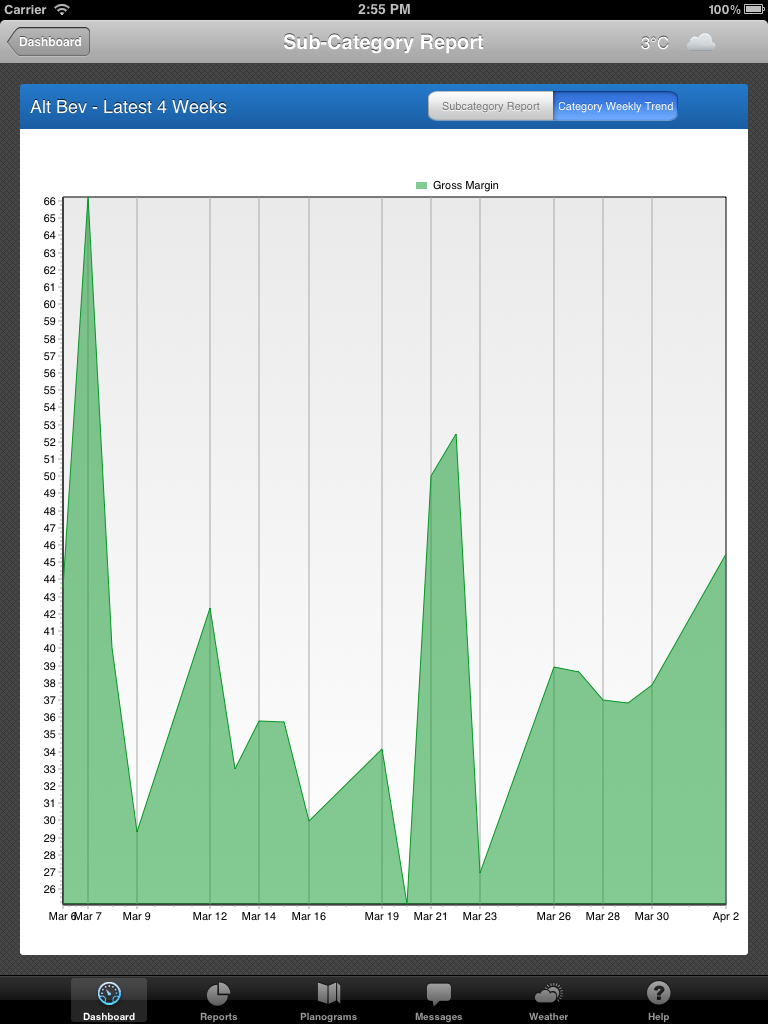

I have an area chart, with dates on the x axis and decimal values on the y axis.
For some reason, the gridlines (and labels) are not spread evenly across the bottom axis. Is there a reason for this?
I noticed that in my data, the dates are not spread evenly, which may account for this. But notice the origin is overlapping, is there a way to fix this?
I'm attaching a screenshot for reference.
iOS Simulator Screen shot 2012-04-11 2.55.22 PM.png (118.5 KiB) Viewed 4361 times

Re: Rendering issues on iPad
Post by Sandra » Tue Apr 17, 2012 10:33 am
Hello toolbox,
Sorry for the delay. I suggest you change the Axes Labels Style property to value, as do in next code:
tChart1.Axes.Bottom.Labels.Style = AxisLabelStyle.Value;
As you see the previous code is code c# for winforms but you should be able to do the same using MonoTouch code. Can you tell us if it solve your problem?
I hope will helps.
