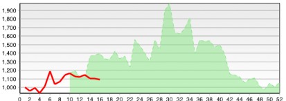

Is there a way to set the starting Y value where X/Y intersect? I have the need to show the lowest value from the Y Axis in the chart. I should note that this chart has both area and line within one chart. Also to note is that this is using the iOS Tchart library.

In the attached screen shot the lowest value is actually 932, so I want to show 900 where x/y intersect in the chart. Currently you'll see in the chart the starting value is 1000.
ios tchart.jpg (24.8 KiB) Viewed 3590 times

Can you tell us if next code help you to solve your problem:
            InitializeChart();
        Steema.TeeChart.Styles.Line lineTY;
        Steema.TeeChart.Styles.Area areaLY;
            double max, min;
            areaLY = new Area(tChart1.Chart);
            lineTY = new Line(tChart1.Chart);
            areaLY.Color = Color.Green;
            areaLY.Transparency = 50;
            lineTY.Color = Color.Red;
            lineTY.LinePen.Width = 2;
            tChart1.Axes.Left.Grid.Visible = false;
            areaLY.AreaLines.Visible = false;
            Random rnd = new Random();
            for (int i = 0; i < 52; i++)
                areaLY.Add(i, rnd.Next(1500));
                lineTY.Add(i, rnd.Next(1500));
            max = Math.Max(areaLY.MaxYValue(), lineTY.MaxYValue());
            min = Math.Min(areaLY.MinYValue(), lineTY.MinYValue());
            tChart1.Axes.Left.SetMinMax(min, max);
Note, that my code is in Winforms and you need adapt it to TeeChart for iOs. Also, can help you to achieve as you want is change the Min/Max offset value,e.g change 0 to 1.
