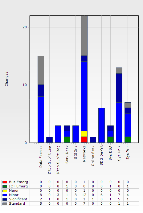

I've created a chart which includes a data table but the data in the datatable only correctly displays when the chart is small or very large.
This image is of the chart not showing all the data in the datatable.

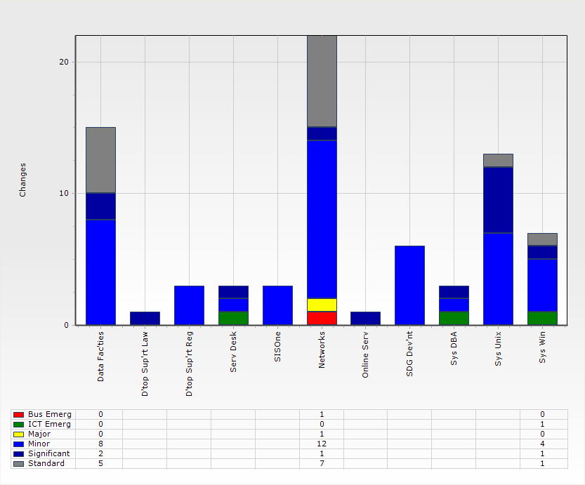

If I resize the chart by dragging the window eventually the missing data appears, also, If I make the chart very large (i.e. drag the window across two screens) the data appears.

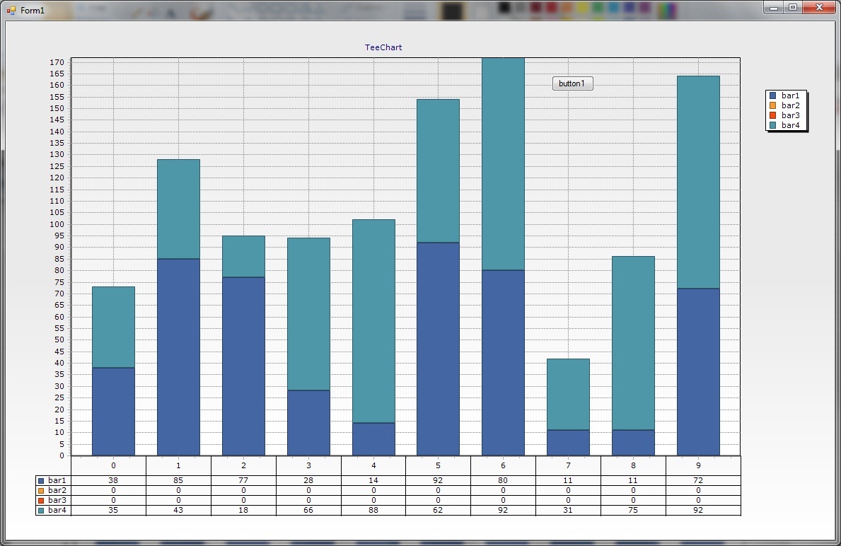

I have got next image where seems where your problem doesn't appears:
Can you confirm us, that in previous image doesn't appear your problem? If you consider that appears, please explain exactly where you think there is the problem.
