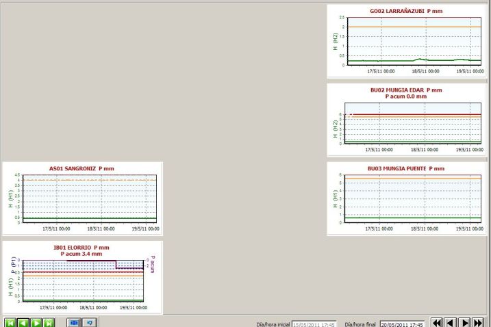

I am updating to VB .NET an old application written in VB6 which created a bunch of graphs, positioned them on screen using a customizable pattern and managed them using an index based approach (Each graph was created at runtime and assigned an index which was used for individual editing, zooming, etc...)
Since index controls have dissapeared in .NET as such I wonder which would be the best way to replicate the same behaviour
I am attaching a screen capture so that you can appreciate what I'm trying to replicate.
Thanks in advance
Multiple graph.jpg (42.09 KiB) Viewed 14937 times

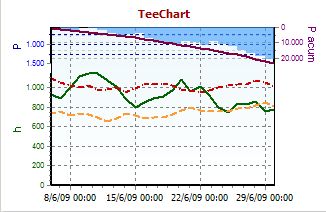

By the way, Gcuadro(0) template looks like this
