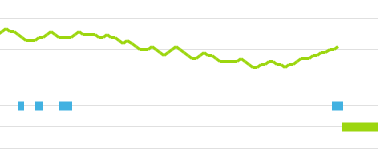

I have a Gantt series that will ultimately need to display thousands of bars. With only ~600 bars, drawing is taking upwards of 15 seconds.
I just need the Gantt to display simple, plain boxes such as those in the attached image. However, when my entire data set is loaded there will be many thousand of them.
Any suggestions to improve drawing performance? (I'm aware I could do some sort of down sampling, which I will do, but I need better chart performance at least with hundreds of boxes).\
graph detail.png (5.08 KiB) Viewed 11437 times
