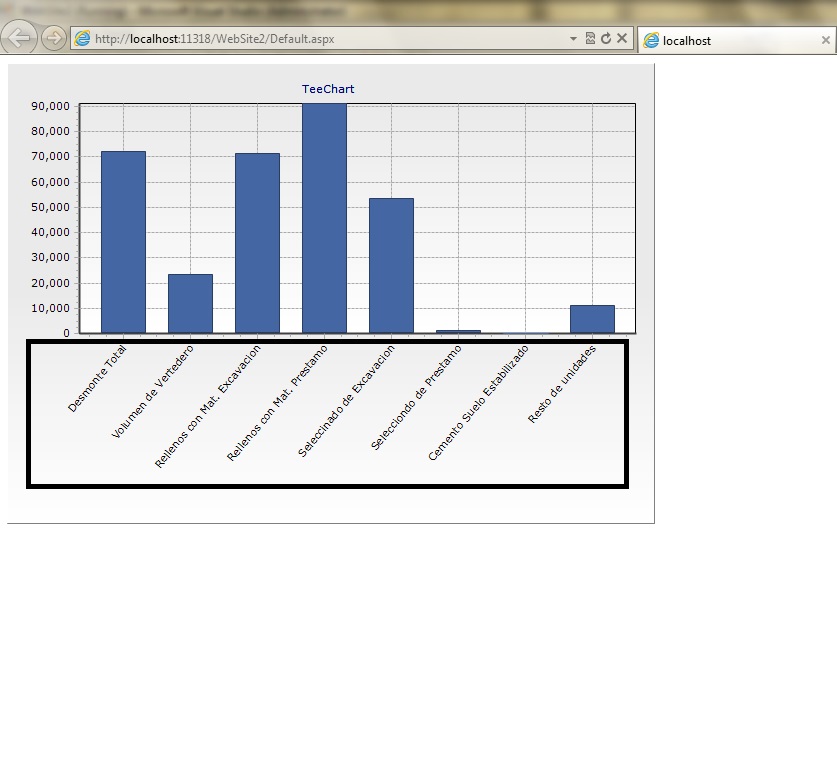

Post by Fulcrum » Tue May 28, 2013 9:34 am
I have tried your solution but now the chart in the webpage dont have all the labels in the axis

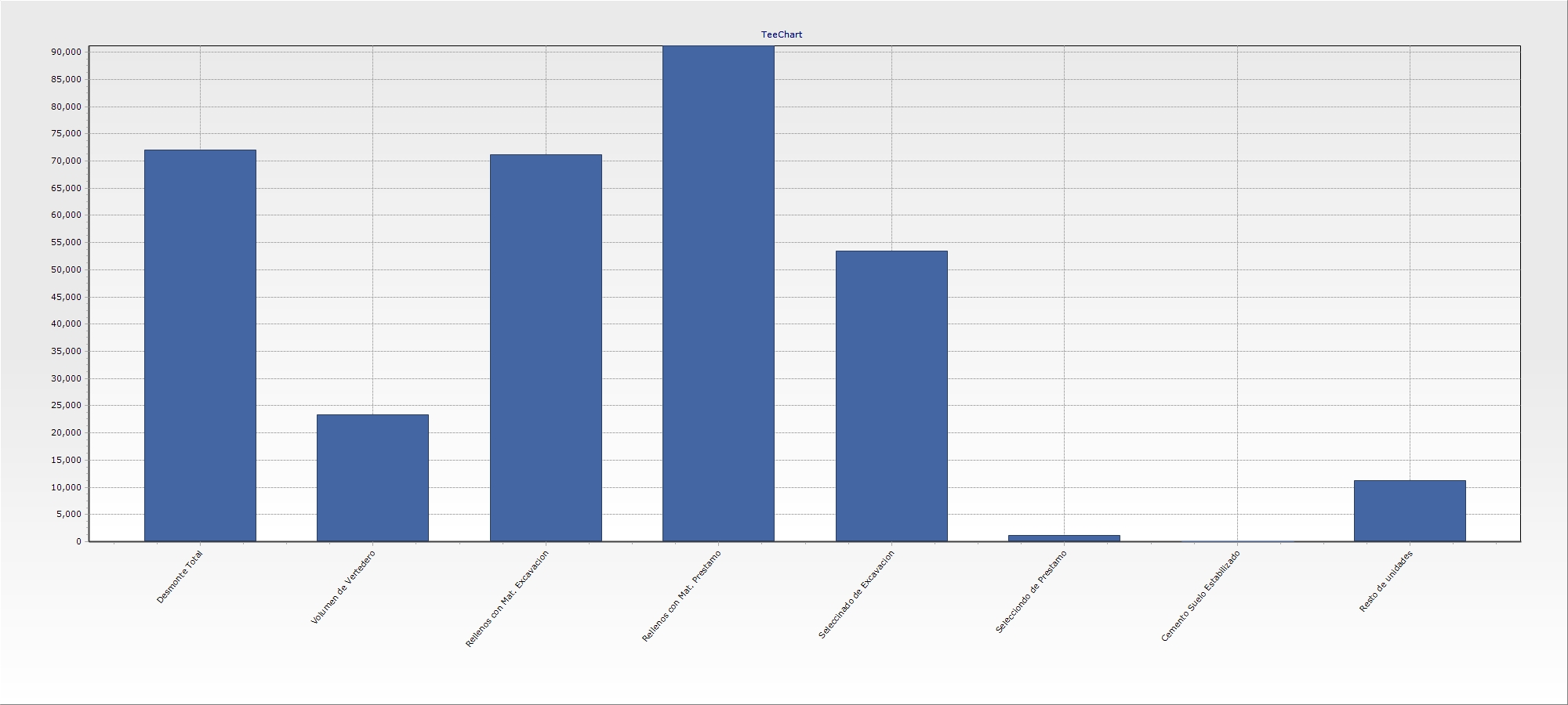

Re: Saving chart with itextsharp
Post by Sandra » Tue May 28, 2013 2:10 pm
Hello Fulcrum,
Using my previous code with last version of TeeChart 2012:
Private series1 As Steema.TeeChart.Styles.Bar
    Private labelstext As String()
    Public Sub New()
        ' This call is required by the designer.
        InitializeComponent()
        InitializeChart()
        ' Add any initialization after the InitializeComponent() call.
    End Sub
    Private Sub InitializeChart()
       WebChart1.Chart.Aspect.View3D = False
        series1 = New Steema.TeeChart.Styles.Bar(TChart2.Chart)
        labelstext = New String() {"Desmonte Total", "Volumen de Vertedero", "Rellenos con Mat. Excavacion", "Rellenos con Mat. Prestamo", "Seleccinado de Excavacion", "Selecciondo de Prestamo", _
            "Cemento Suelo Estabilizado", "Resto de unidades"}
        series1.Add(72049.79, "Desmonte Total")
        series1.Add(23371.14, "Volumen de Vertedero")
        series1.Add(71177.12, "Rellenos con Mat. Excavacion")
        series1.Add(91177.12, "Rellenos con Mat. Prestamo")
        series1.Add(53371.14, "Seleccinado de Excavacion")
        series1.Add(1177.11999999999, "Selecciondo de Prestamo")
        series1.Add(0, "Cemento Suelo Estabilizado")
        series1.Add(11177.12, "Resto de unidades")
        series1.Marks.Visible = False
        WebChart1.Chart.Legend.Shadow.Visible = True
        WebChart1.Chart.Legend.Visible = False
        'CUSTOM LABELS
        AddCustomLabels(series1, labelstext)
        WebChart1.Chart.Axes.Bottom.Labels.Angle = 50
       WebChart1.Chart.Export.Image.JPEG.Quality = 100
       WebChart1.Chart.Export.Image.JPEG.Width = 2000
       WebChart1.Chart.Export.Image.JPEG.Height = 900
       WebChart1.Chart.Export.Image.JPEG.Save("C:\ImagenInformeTripleBarras3.jpeg")
    End Sub
    Protected Sub AddCustomLabels(s As Steema.TeeChart.Styles.Series, arraylabels As String())
       WebChart1.Chart.Axes.Bottom.Labels.Items.Clear()
        For i As Integer = 0 To series1.Count - 1
           WebChart1.Chart.Axes.Bottom.Labels.Items.Add(s.XValues(i), arraylabels(i))
        Next
    End Sub
I have achieved next result in the browser:
I have gotten next image using your indications to export the chart:
I consider the results are correct. For this reason,I would be very grateful if you can indicate us, if the problem appears in my attached images. If it doesn't appear, please try to modify the code, so we can reproduce your problem here. On the other hand, could you please tell us which version of TeeChart are you using in this moment?

Post by Fulcrum » Wed May 29, 2013 12:17 pm
yes the problema is in the second chart and in my intructions for saving the chart.
In my web the chart dont have all the axis
so to make then to appear I have to make the image larger
Now I havee notice something in your code that i didnt do when I tried it
when you define series1 you use TChart2, how do you define it. I defined it like the chart I was using and that could be my mistake.
Do I have to define a second chart?

Post by Sandra » Thu May 30, 2013 9:27 am
Hello Fulcrum,
I have attached my project where your problem doesn't appear using latest versions of TeeChartFor.Net (4.1.2012.01312). For this reason, we would be very grateful if you can check my attached project and inform us of results you get.
On the other hand, could you confirm us which version are you using?
WebSite7.zip
(5.98 KiB) Downloaded 493 times
CODE: SELECT ALL
Sorry, I have forgotten to remove this line of code, isn't necessary.
Fulcrum
Posts: 35
Joined: Fri Dec 21, 2012 12:00 am
Post by Fulcrum » Thu May 30, 2013 12:17 pm
Hello Sandra and thank you, your projects Works fine and I have fixed the problema but when i tried in this one dont seem it solves anything.
labelstext1 = New String() {"Hormigon", "Acero Estructural", "Acero con Arma. Pasivas", "Acero en Pretensados"}
        Dim ch1 As Steema.TeeChart.Chart = WebChartTripleBarras1.Chart
        ch1.Series.RemoveAllSeries()
        ch1.Series.Add(New Steema.TeeChart.Styles.Bar())
        Dim SeriesBar1 As New Steema.TeeChart.Styles.Bar()
        SeriesBar1.Add(72049.789999999994, "Hormigon")
        SeriesBar1.Add(23371.139999999999, "Acero Estructural")
        SeriesBar1.Add(71177.119999999995, "Acero con Arma. Pasivas")
        SeriesBar1.Add(91177.119999999995, "Acero en Pretensados")
        SeriesBar1.Marks.Visible = False
        'ch1.Legend.Shadow.Visible = True
        ch1.Legend.Visible = False
        ch1.Series(0).ShowInLegend = False
        'ch1.Series(0).Color = Color.CornflowerBlue
        ch1.Walls.Back.Gradient.Visible = False
        ch1.Walls.Back.Color = Color.White
        ch1.Panel.Gradient.Visible = False
        ch1.Panel.Color = Color.White
        ch1.Axes.Bottom.Labels.Angle = 30
        SeriesBar1.Color = Color.Blue
        SeriesBar1.Gradient.StartColor = Color.RoyalBlue
        SeriesBar1.Gradient.MiddleColor = Color.DodgerBlue
        SeriesBar1.Gradient.EndColor = Color.DeepSkyBlue
        SeriesBar1.Gradient.UseMiddle = True
        SeriesBar1.Gradient.Visible = True
        SeriesBar1.BarStyle = Steema.TeeChart.Styles.BarStyles.RectGradient
        AddCustomLabelsBar1(SeriesBar1, labelstext1)
        ch1.Series.Add(SeriesBar1)
        'ch1.Panel.Bevel.Outer = Steema.TeeChart.Drawing.BevelStyles.None
        JpegBarras1.Quality = 100
        JpegBarras1.Width = 900 'm_PictureBox.Width
        JpegBarras1.Height = 700 'm_PictureBox.Height
        WebChartTripleBarras1.Chart.Export.Image.JPEG.Save("C:\ImagenInformeTripleBarras1Final.jpeg")
Could it be I miss something?
Post by Sandra » Thu May 30, 2013 3:02 pm
Hello Fulcrum,
I have modified a little your code and using it but my AddCustomLabels method, your code works in correct way:
    Private ch1 As Steema.TeeChart.Chart
        ch1 = WebChart1.Chart()
        labelstext = New String() {"Hormigon", "Acero Estructural", "Acero con Arma. Pasivas", "Acero en Pretensados"}
        Dim SeriesBar1 As New Steema.TeeChart.Styles.Bar(ch1)
        SeriesBar1.Add(72049.79, "Hormigon")
        SeriesBar1.Add(23371.14, "Acero Estructural")
        SeriesBar1.Add(71177.12, "Acero con Arma. Pasivas")
        SeriesBar1.Add(91177.12, "Acero en Pretensados")
        AddCustomLabels(SeriesBar1, labelstext)
        WebChart1.Chart.Export.Image.JPEG.Save("C:\ImagenInformeTripleBarras1Final.jpeg")
    End Sub
    Protected Sub AddCustomLabels(ByVal s As Steema.TeeChart.Styles.Series, ByVal arraylabels As String())
        ch1.Chart.Axes.Bottom.Labels.Items.Clear()
        For i As Integer = 0 To s.Count - 1
            ch1.Chart.Axes.Bottom.Labels.Items.Add(s.XValues(i), arraylabels(i))
        Next
    End Sub
I have made the test in VS2008 and latest version of TeeChartFor.Net. Do you use last version of TeeChartFor.Net?
Fulcrum
Posts: 35
Post by Fulcrum » Mon Jun 03, 2013 10:29 am
Thank you for everything Sandra, the problema is finally solved
