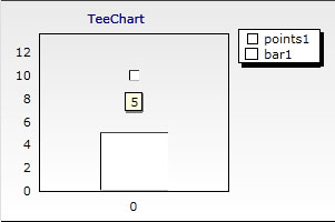

Source:

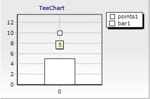

Result:
If you open exported XAML with text editor, you can see incorrect part:
<Rectangle Fill="#FFFFFFFF" StrokeThickness="1" Stroke="#FF000000"
Canvas.Left="115.176666666667" Canvas.Top="63" Width="10" Height="10">
<Rectangle.Clip>
<RectangleGeometry Rect="0,0,9,9"/>
</Rectangle.Clip>
</Rectangle>
Canvas.Left="89.1766666666667" Canvas.Top="119" Width="62" Height="53">
<Rectangle.Clip>
<RectangleGeometry Rect="0,0,61,52"/>
</Rectangle.Clip>
</Rectangle>
