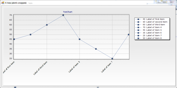

I have made a TeeChart with the following code:
            chartToTest.Aspect.View3D = false;
            Steema.TeeChart.Styles.Line line = new Steema.TeeChart.Styles.Line(chartToTest.Chart);
            line.Add(1, 45, "Label of first item");
            line.Add(2, 50, "Label of second item");
            line.Add(3, 60, "Label of third item");
            line.Add(4, 70, "Label of item 4");
            line.Add(5, 45, "Label of item 5");
            line.Add(6, 35, "Label of item 6");
            line.Add(7, 25, "Label of item 7");
            line.Add(8, 50, "Label of item 8");
            line.Pointer.Visible = true;
            chartToTest.Axes.Bottom.Labels.Angle = 45;
this results in the chart you can see in the attached screenshot.
Why can I only see the labels number 1, 3, 5 and 7? I would expect to see all the labels, as I rotated them.

Re: labels disappear
Post by Sandra » Fri Jun 21, 2013 11:56 am
Hello Marijke Van Bergen,
The labels are positioned automatically and you need force the position of labels you want painting. Therefore I think to achieve as you want, you need use custom labels as do in next simple code:
      string[] labels = new string[]{"Label of first item","Label of second item","Label of third item","Label of item 4",
        "Label of item 5","Label of item 5", "Label of item 6","Label of item 7","Label of item 8"};
      Steema.TeeChart.Styles.Line line1 = new Line(tChart1.Chart);
      line1.Add(1, 45);
      line1.Add(2, 50);
      line1.Add(3, 60);
      line1.Add(4, 70);
      line1.Add(5, 45);
      line1.Add(6, 35);
      line1.Add(7, 25);
      line1.Add(8, 50);
      AddCustomLabels(line1,labels);
      line1.Pointer.Visible = true;
     tChart1.Axes.Bottom.Labels.Angle = 45;
    private void AddCustomLabels(Steema.TeeChart.Styles.Series s, string[] arrayLabels)
      for (int i = 0; i < s.Count; i  )
        tChart1.Axes.Bottom.Labels.Items.Add(s.XValues[i], arrayLabels[i]);

Post by OMP » Mon Jun 24, 2013 7:07 am
Thank you very much.
This solves my issue.
