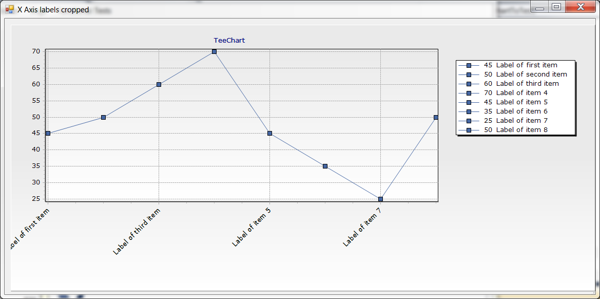

If we have long text labels on the X Axis, the first label gets cropped when we rotate them. see screenshot attached.
What can I do to make sure that the label does not get chopped off.

I recommend try to increase the space of MarginLeft adjusting it to your convenience. For example, you can do something as next:

The problem with this solution is that our data on the chart (including the labels) in very dynamic. We never know the length of the labels, so setting a hard coded margin is not the best solution. We are looking for a solution that takes into account the length of the labels.

You can use MaxLabelsWidth to calculate the width of your labels:
 private void CalcMargins()
      tChart1.Draw();
      tChart1.Panel.MarginUnits = Steema.TeeChart.PanelMarginUnits.Pixels;
      tChart1.Panel.MarginLeft = tChart1.Panel.MarginLeft+tChart1.Axes.Bottom.MaxLabelsWidth();
My recommendation is you use a similar code as previous to fix your problem.
