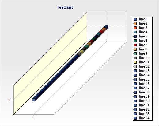

Dear,
When I add more then 25 lines in my chart which all have only 1 point, my 3D chart looks strange.
This my code:
chartToTest.Aspect.View3D = true;
            for (int i = 0; i < 30; i++)
               Steema.TeeChart.Styles.Line line = new Steema.TeeChart.Styles.Line(chartToTest.Chart);
               line.Pointer.Visible = true;
               line.Add(0, "");
Kind regards
3D chart.PNG (17.77 KiB) Viewed 12634 times

When I was making the test project, I have noticed that it depends on the size of the window and the number of lines that are used.
In the test project I couldn't reproduce it with 30 lines, but when 50 lines are used, the issue is still there.
I will send the test project to support.

Re: 3D chart loses axes
Post by Sandra » Wed Jul 03, 2013 10:18 am
Hello OMP,
We consider it as an enhancement and for this reason we have added it in wish-list with number [TF02016632] to we will consider its inclusion in future maintenance releases of TeechartFor.Net.
