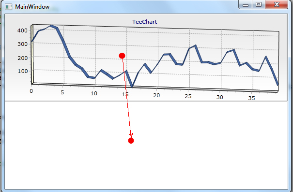

Yes, the problem appears with your code too. But to reproduce it you should move mouse with pressed button out of TChart (but not out of Window) and then release button.
Try to use the following xaml:

Mouse movement should be like this:

Hello neurosfot,
Thanks for your indication. I have added your request in bug list report with number [TW16016672]. We will try to fix it to upcoming maintenance releases of TeeChartWPF.
