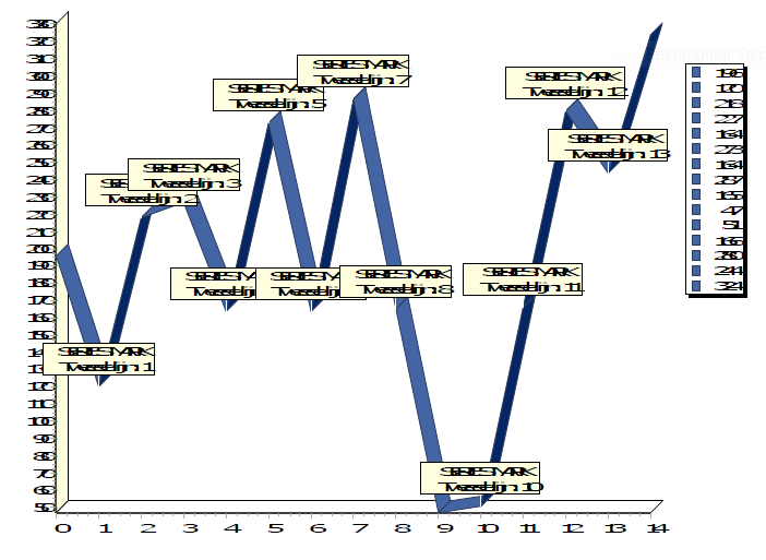

We have an issue with our chart when printing. When we print the chart (with Chart Editor > Print), and we choose PDF Creator, we get the result as what you can see in the attached image. To get the image, I have made a screenshot of the pdf, because I can't upload pdf files to this topic.
Do you have any idea what can be wrong? We only experience this issue on one pc. Could it be related with locale settings on that particular computer? Did you ever experience these kind of issues with other TeeChart users?
Thanks in advance,
Marijke Van Bergen
You could compress it in a zip package and upload it.
I'm afraid not. If you send us the code or .ten file generating that chart we will test it here.
Most likely. Can you visualize this PDF file correctly in other computers? PDF files created in other computers can be seen correctly on this PC?
Not that I'm aware of.

As you see there is two buttons to compare the result of exportation in pdf format. The first opens the TChart editor to allow export the image by Editor. The second allows you export directly the chart as pdf. We would be grateful, if you can't reproduce the problem with my code, modifies code because we can reproduce the problem here and try to find a solution for you.
On the other hand, could you tell us which version of TeeChartFor.Net are you using?

Thanks everyone for your support. In the meantime we figured out what the cause of the problem was.
It was due to another third party application.
Anyway,
thanks for your help.
Marijke
