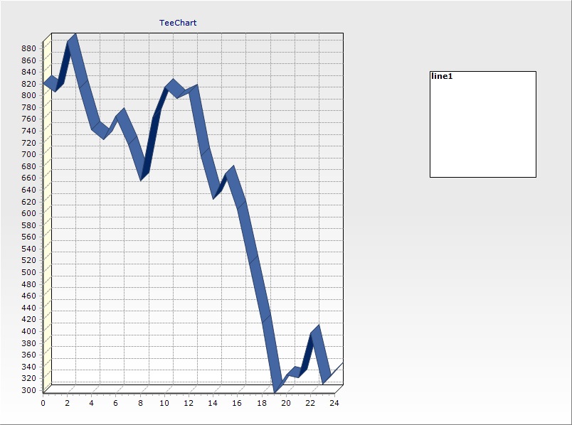

Hello Jay,
Using next code to make a custom legend:
I can export correctly the Chart and custom legend. See images GIF, JPEG, results:

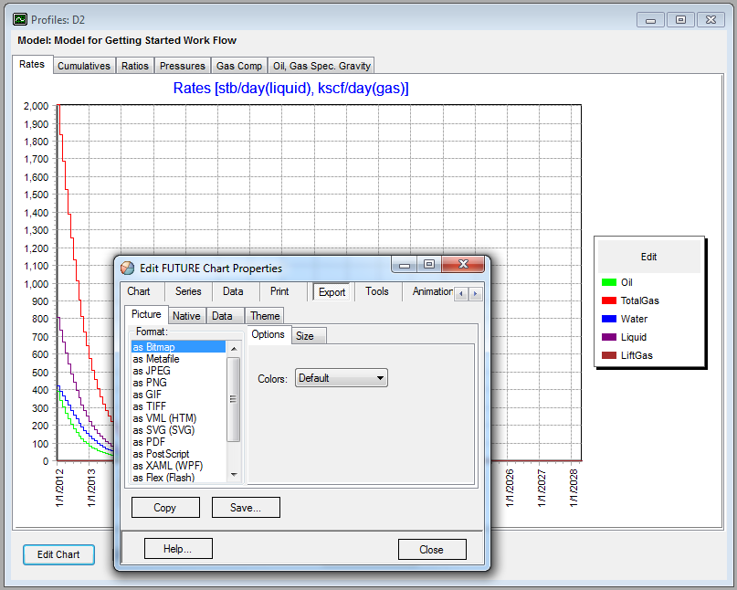

Hi Sandra,
How could we make this approach work with the Export tab of Steema.TeeChart.Editor?
We expose your editor to our users allowing them to customize charts, especially for reporting purposes. It seems to me, that any of your customers that extend TeeChart with custom annotations or legends would want the underlying TChart.Export.Image.xxx.Save(...) methods to exhibit WYSIWYG behavior by implementing the BitMap technique you suggest.
Would you agree that this is a valid feature request? Anything we implement would not extend the Steema.TeeChart.Editor, so unless you implement this within TeeChart, the Export feature of the Editor will not behave as users would expect.

- Steema.TeeChart.Editor
- Steema.TeeChart.Editor.png (63.01 KiB) Viewed 12868 times
