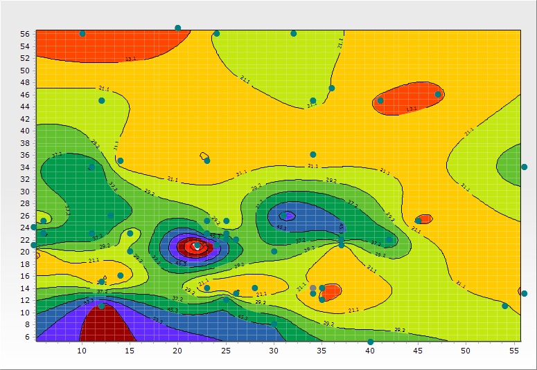

I have plotted some data on the contour and isosurface series. I have a problem with charts showing white grid lines. How can I remove the grid lines?

I have set
tChart1.Axes.Bottom.Grid.Visible = false;
tChart1.Axes.Left.Grid.Visible = false;
but this has no effect on the contour and isosurface grid.

Also, they do not look like axes grid lines to me. They look more like the grid cell borders of the contour map.

I found the solution...Smoothingmode=highspeed.
Re: Grid lines on contour series
Post by Sandra » Tue Sep 27, 2011 10:03 am
Hello lilo,
Thank you for information. I have checked your suggestions to tChart1.Aspect.SmoothingMode = System.Drawing.Drawing2D.SmoothingMode.HighSpeed; and I consider it as a good solution to solve the problem.
