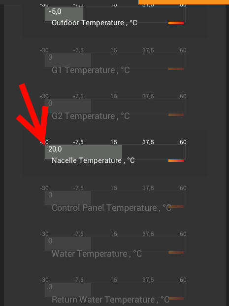

Hi! I'm using Xamarin.Android teechart.
I want to place numeric representation of value in LinearGauge in center of bar (like on screenshot)
I draw that value in AfterDraw event.
But when i calculate size from the top left corner of chart - and adjust it to specific device - on another device it is in wrong place (i use proper px to dp transformation). I need calculate text position from border top left corner (not whole chart corner)
1) how to get border top left corner coordinates (red arrow on screenshot)? i can't find appropriate properties.
2) how to change border color?
Thanks in advance

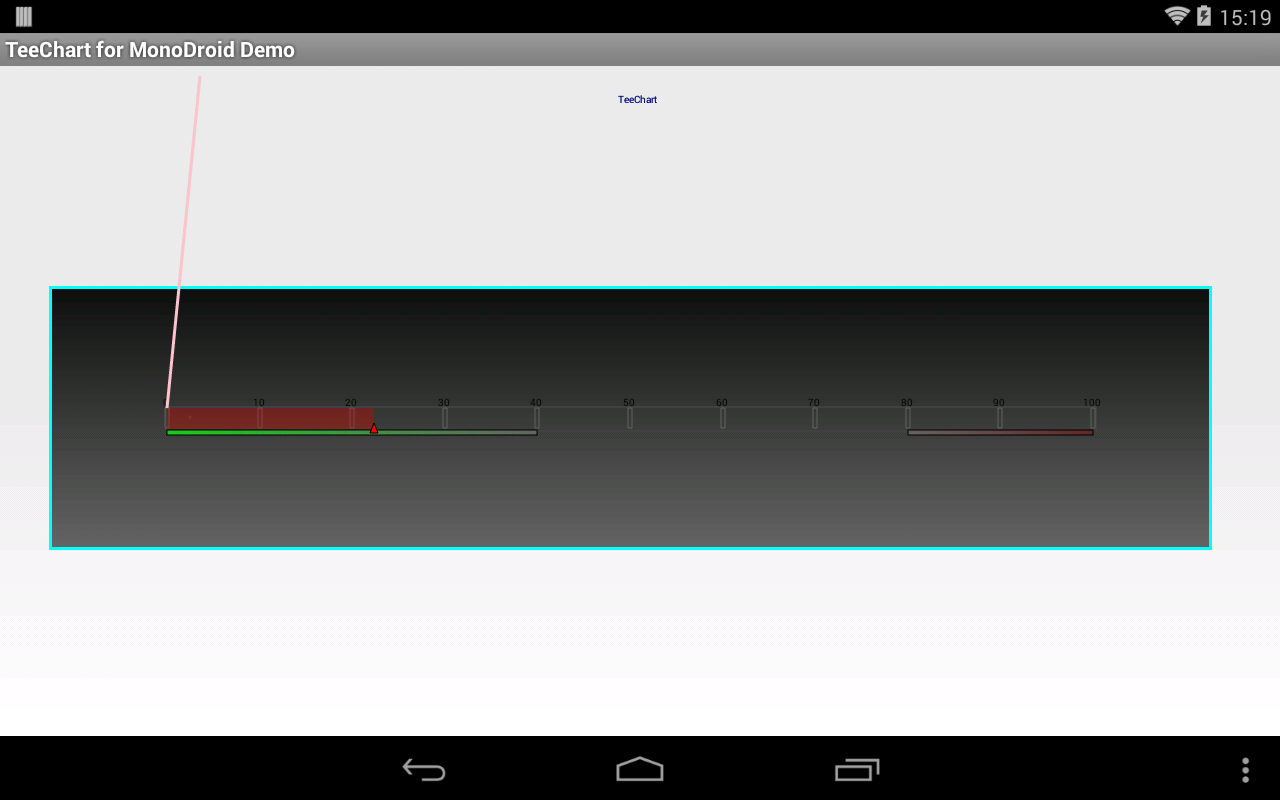

Hi Thomas,
1. You can do this:
  public class MyLinearGauge : LinearGauge
    public MyLinearGauge(Chart chart) : base(chart) { }
    public Rectangle AxisRectangle
      get
        int height, width, x, y;
        if (Horizontal)
          height = Ticks.VertSize;
          width = Utils.Round(INewRectangle.Width * 0.8);
          x = (INewRectangle.X + (INewRectangle.Width / 2)) - (width / 2);
          y = INewRectangle.Y + ((INewRectangle.Height - height) / 2);
          height = Utils.Round(INewRectangle.Height * 0.8);
          width = Ticks.VertSize;
        return new Rectangle(x, y, width, height);
  [Activity(Label = "TeeChart for MonoDroid Demo", MainLauncher = true)]
  public class Activity1 : Activity
    protected override void OnCreate(Bundle bundle)
      base.OnCreate(bundle);
      InitializeChart();
    private Steema.TeeChart.TChart tChart1;
    MyLinearGauge gauge;
      tChart1 = new Steema.TeeChart.TChart(this);
      gauge = new MyLinearGauge(tChart1.Chart);
      gauge.FillSampleValues();
      tChart1.AfterDraw += tChart1_AfterDraw;
      gauge.Frame.InnerBand.Color = Color.Cyan;
      SetContentView(tChart1);
      Point topleft = gauge.AxisRectangle.Location;
      g.Pen.Width = 3;
      g.Pen.Color = Color.Pink;
      g.Line(topleft, new Point(200, 10));
2. See gauge.Frame.InnerBand.Color property in the example.

Thanks. 1-st part works perfect.
Frame color deosn't work. When i make FrameVisible, disable Middle and outer bands It draws one more rectangle outside small thin frame. Seems like frame on first screenshot - is not related to LinearLayout.Frame property.

Hi Thomas,
Thomas wrote: Frame color deosn't work. When i make FrameVisible, disable Middle and outer bands It draws one more rectangle outside small thin frame. Seems like frame on first screenshot - is not related to LinearLayout.Frame property.
I'm not sure about which is the problem you describe. Adding this code:
      gauge.Frame.Visible = true;
      gauge.Frame.MiddleBand.Visible = false;
      gauge.Frame.OuterBand.Visible = false;
I get a chart like in the image below. Is that what you get? What's the problem with it?

Still cannot change border color (see my 1st post in this topic).
Frame property is other frame, not the frame near hand (see attachment to first post).

Apologies for the misunderstanding. That frame is the axis, hence you can change its pen properties like this:
      gauge.Axis.AxisPen.Color = Color.Red;
      gauge.Axis.AxisPen.Width = 5;
Is that what you were looking for?
