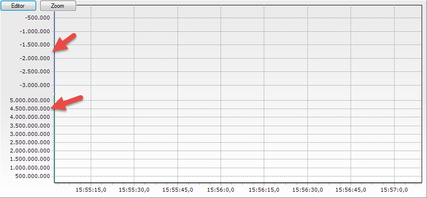

I have one question left. I use the zoomed Event from the chart to Zoom, the custom Axes, too.
Now we have a layout where we stack the Y axes. The sample app has a TEE file for demonstrating.
If you use the Zoom button the X axis works like expected. But the Y Axes always do a Zoom out.
Any hint why this happens?
Very strange zooming :)

Re: Zooming with ZoomRect
Post by Christopher » Wed May 07, 2014 1:19 pm
moelski.net wrote: Very strange zooming :)
This is because the call to:
this.tChart1.Zoom.ZoomRect(r);
does not use custom axes. You will have to set the Axis.SetMinMax() "manually" for each axes you want to zoom in the case of using custom axes.

Hi Christopher,
That is whar I did. Take a look at my code / or my sample:
        private void tChart1_Zoomed(object sender, EventArgs e)
            if (this.tChart1.Zoom.Direction == ZoomDirections.Both ||
                this.tChart1.Zoom.Direction == ZoomDirections.Vertical)
                for (int i = 0; i < this.tChart1.Axes.Count; i++)
                    var axis = this.tChart1.Axes[i];
                    if (!axis.Horizontal && axis.IsCustom())
                        axis.SetMinMax(
                            axis.CalcPosPoint(((TChart)sender).Zoom.y1),
                            axis.CalcPosPoint(((TChart)sender).Zoom.y0));
But it did not work as expected for me. Maybe the calculation for the SetMinMax values is wrong?
Dominik
Post by Christopher » Thu May 08, 2014 2:08 pm
Hello Dominik,
moelski.net wrote: But it did not work as expected for me. Maybe the calculation for the SetMinMax values is wrong?
You can try something like:
        void tChart1_UndoneZoom(object sender, EventArgs e)
              axis.Automatic = true;
              Rectangle rect = Utils.FromLTRB(((TChart)sender).Zoom.x0, ((TChart)sender).Zoom.y0, ((TChart)sender).Zoom.x1, ((TChart)sender).Zoom.y1);
              Rectangle chartRect = tChart1.Chart.ChartRect;
              double ratio = 1.0 / ((double)chartRect.Height / (double)rect.Height);
                if (!axis.Horizontal && axis.IsCustom() && (axis.IStartPos < rect.Bottom))
                  axis.Automatic = false;
                  axis.Maximum *= ratio;
                  axis.Minimum *= ratio;
Here the axis is only being zoom if the bottom of the zoom rectangle is below the beginning of the axis. More "intelligence" can be added here to ensure the right axes are being zoomed at the right time.
