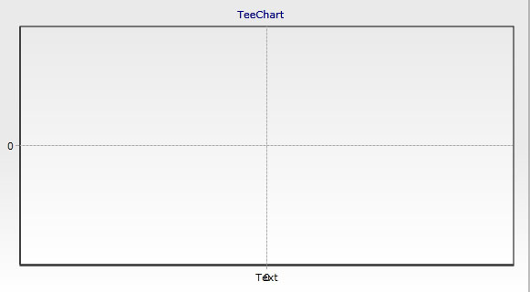

I'm using the latest version of WPF TChart. In this version Bottom axis title is located over zero mark when series is empy.
MyTChart.Aspect.View3D = false;
Bar bar = new Bar();
MyTChart.Series.Add(bar);
MyTChart.Axes.Bottom.Title.Text = "Text";
It looks like this:

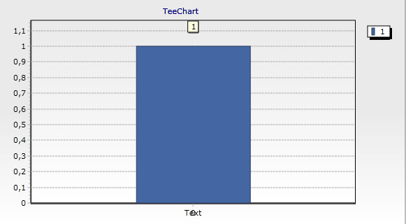

Adding of one bar value doesn't resolve the problem:
bar.Add(1);

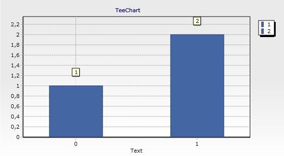

But if I add two bar values the axis title becomes located fine:
bar.Add(1);
bar.Add(2);

Hello!
neurosoft wrote:Hello steema!
Yes, I have been able to reproduce this issue here and have added it to our bug database with id=778. Please note the temporary workaround:
tChart1.Axes.Bottom.Title.Text = Utils.NewLine + "Text";
Apologies for any inconvenience.
