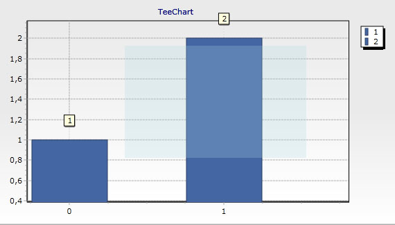

I'm testing the latest version of WPF TChart and I have a question. Is it normal that the selection area has no borders?

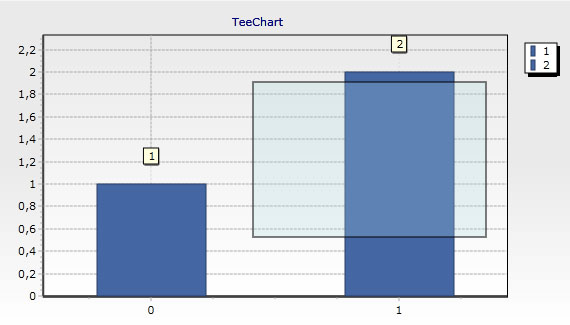

In preveous versions (v4.1.2013.7302 for example) it has.

Yes, the default value of the Visible property of the Zoom.Pen was changed to false in the fix to id=760. This can be reversed by:
tChart1.Zoom.Pen.Visible = true;
