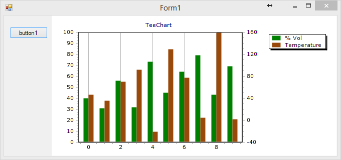

Post by Christopher » Fri Jun 06, 2014 9:07 am
Hello!
tms4000 wrote:I have a horizontal bar chart with 2 series. One series is a percentage using the left axis. The axis is set to run from 0% to 100%. The second series is using the right axis and represents a temperature. Potential values are -40 - 160. I would like the second series bar to start at the base of the chart instead of starting at zero.
The following code:
      tChart1.Axes.Right.Grid.Visible = false;
      tChart1.Axes.Right.Maximum = 160.0;
      tChart1.Axes.Right.Minimum = -40;
      tChart1.Axes.Right.Increment = 40;
      tChart1.Axes.Right.Automatic = false;
      tChart1.Axes.Right.AutomaticMinimum = false;
      tChart1.Axes.Right.AutomaticMaximum = false;
      tChart1.Panel.Bevel.Inner = Steema.TeeChart.Drawing.BevelStyles.None;
      tChart1.Panel.Bevel.Outer = Steema.TeeChart.Drawing.BevelStyles.None;
      tChart1.Axes.Left.Grid.Visible = false;
      tChart1.Axes.Bottom.Grid.Centered = false;
      tChart1.Axes.Bottom.Ticks.Visible = false;
      tChart1.Axes.Left.Automatic = false;
      tChart1.Axes.Left.Minimum = 0;
      tChart1.Axes.Left.Maximum = 100;
      tChart1.Axes.Right.Visible = true;
      var barProduct = new Steema.TeeChart.Styles.Bar();
      barProduct.MultiBar = MultiBars.Side;
      barProduct.Color = Color.Green;
      barProduct.Marks.Visible = false;
      barProduct.Title = "% Vol";
      barProduct.ShowInLegend = true;
      Random rnd = new Random();
      for (int i = 0; i < 10; i++)
        barProduct.Add(rnd.Next(0, 100));
      tChart1.Series.Add(barProduct);
      var barTemperature = new Steema.TeeChart.Styles.Bar();
      barTemperature.MultiBar = MultiBars.Side;
      barTemperature.Color = Color.FromArgb(153, 74, 11);
      barTemperature.Marks.Visible = false;
      barTemperature.VertAxis = VerticalAxis.Right;
      barTemperature.UseOrigin = true;
      barTemperature.Origin = -40;
      barTemperature.Title = "Temperature";
      barTemperature.ShowInLegend = true;
        barTemperature.Add(rnd.Next(-40, 160));
      tChart1.Series.Add(barTemperature);
      tChart1.Walls.Back.Color = Color.White;
gives me the following chart:
Do you get the same results at your end?

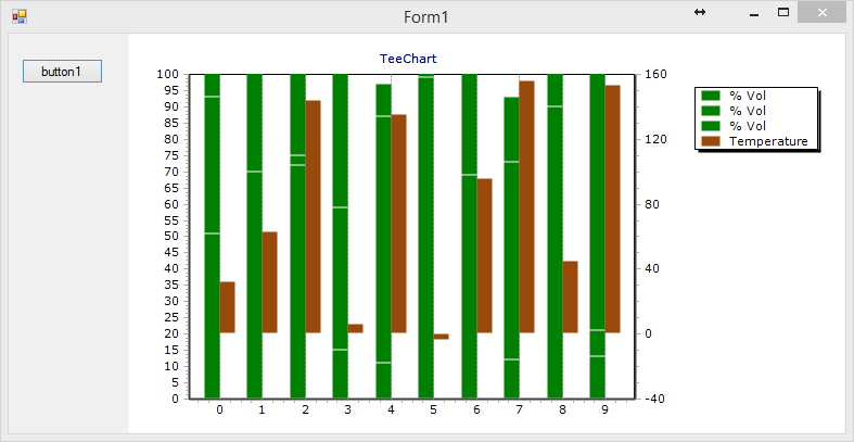

Re: Using none zero Origin on a bar series.
Post by Christopher » Mon Jun 09, 2014 9:09 am
tms4000 wrote:When I remove the SP1 SP2 and SP3 series and change the Mutibar property on the product seriers to MultiBars.Side, the Temperature series responds correctly to the origin property.
When I set Product.Multibar = Multibar.Stacked, the temperature series acts like 0 is the origin.
Just to confirm exactly what the issue is. I think I can reproduce the problem using this code:
      for (int j = 0; j < 3; j++)
        barProduct.MultiBar = MultiBars.Stacked;
        barProduct.StackGroup = 0;
      barTemperature.MultiBar = MultiBars.Stacked;
      barTemperature.StackGroup = 1;
which gives me this chart:
is this the issue you're referring to? If so I'll add it to http://bugs.teechart.net/ if you haven't done so already.
